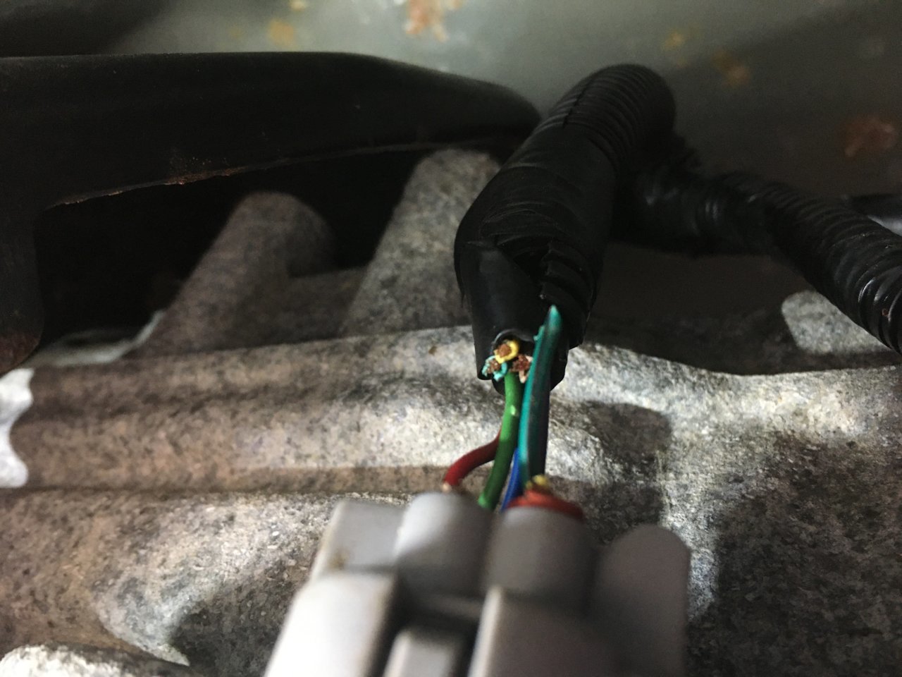

    Check engine light and traction light turn on, got a code P2716 and P2743. Temp sensor B Circuit. So I checked the wiring and sure enough the mouse chewed it flush to the connector leaving nothing to splice to. Maybe I can get a junkyard to sell me a section.IMG_2201.jpg

    It's the Transmission Temp sensor plug.

    Can you re-pin the plug?

    I don't know. Or replace the plug if I could find out what it is.

    There will be a number on the plastic connector housing. Get that number and that will help you out a bunch.

    -The only number I can see is 5a51 but it looks like 90980-10891 or -11190

    I am 95% sure that 90980-10891 is the transmission connector for the 2TR-FE. That should be the connector for the solenoids. I see 7 wires in the solenoid connector schematic and they match up with the colors I can see in your pic. From what I see, it looks like the trans temp sensor is a separate 2 wire connector. You might look and see if the mouse chomped that too.
    Going on the assumption that 90980-10891 is correct, that Amazon connector looks right. Another way to fix it would be to buy Toyota pigtails and solder them in. Again, assuming 90980-10891 is correct, the Toyota pigtails would be 82998-12440. They're about $8 each. Your local Toyota dealer should be able to get them overnight with no shipping charge.
