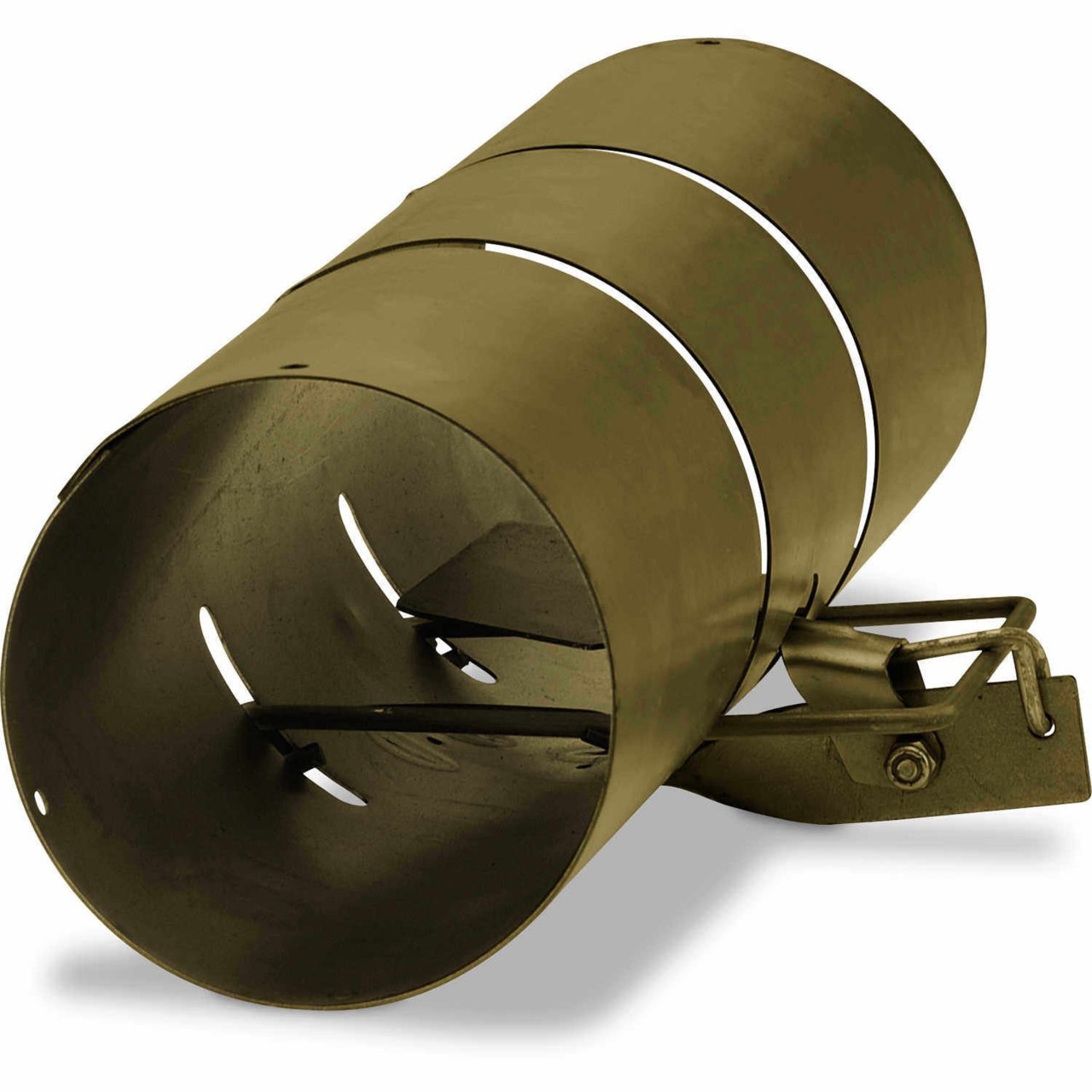

    In that case, Rodenticide (containing Bromethalin) might not be a good idea. Although it's very effective against any type of rodents.
    Every winter, I store my '17 Shelby GT350..... and there were a few mice that were attempting to make a home under the hood. The treats containing Bromethalin, worked great.
    However, a more quick and lethal approach is a trap that's designed for squirrels. It's designed so well, it will kill mice as well, even critters that you didn't know you had. (Just watch your fingers.... while setting it). Both of these solutions can be obtained from Amazon.

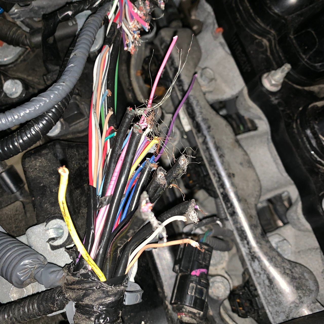

    I have chipmunks nest in my engine bays and have figured out how to keep them out. The pic below was what my wife's engine was getting overnight. Sprinkled cayenne pepper in the engine bay and stopped getting this instantly. I keep it fresh throughout the winter and have had no problems(WITH ONE CAVEAT)
    Wife's wiring got chewed thru even after no rodents were nesting and with cayenne on the engine. I had the harness changed and started spraying the wiring with Fluid Film. No more damage or nesting since then. Strange thing is that we NEVER had chewed wiring until I started using the cayenne. It was almost a "F you! You won't let us nest so we gonna F you up!"
    TLDR: Cayenne in the engine bay, Fluid Film on the wiring keeps them away.

    If you sprayed Fluid Film on the wires, then maybe that is what caused the chewed wires, in spite of the presence of cayenne in the rest of the engine bay.
  17. Oct 25, 2019 at 7:58 AM
    #97
    Steve Urquell
    Steve Urquell No Pants
    Nov 30, 2016
    #203716
    892
    2017 2.7L/5MT AC Utility 4X4
    The engine only had cayenne on it when the wires got chewed. The FF was sprayed on after the wiring was replaced. No more activity in the engine bay with FF and cayenne.
    ETA: Cayenne stopped the nesting
    FF stopped the chewing

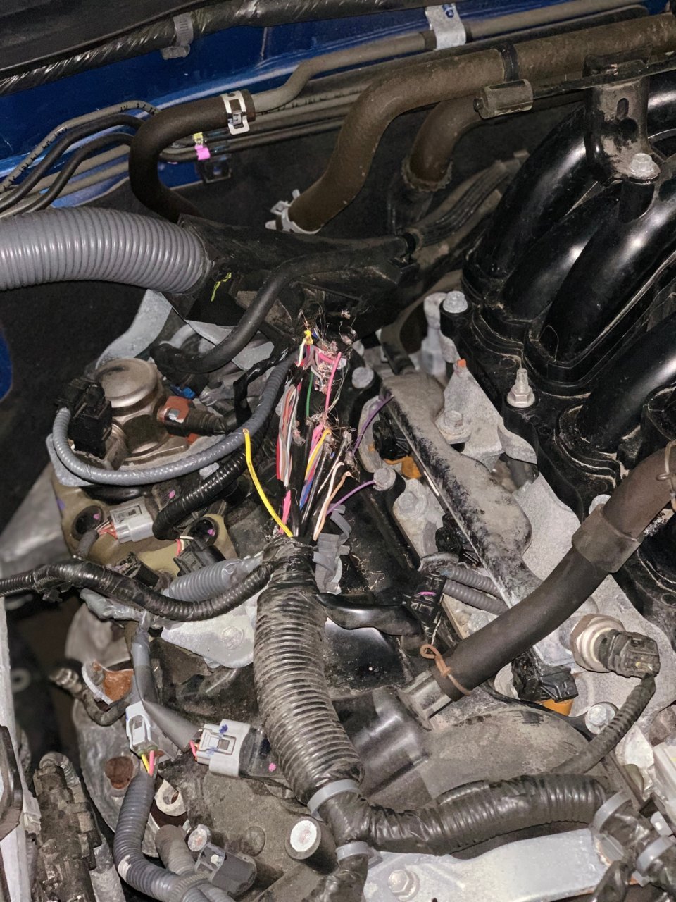

  20. Oct 26, 2019 at 4:16 PM
    #100
    Black Magic 2003
    Black Magic 2003 Well-Known Member
    Jan 5, 2012
    #70009
    85
    Edwin
    Mass
    19 Tacoma TRD Pro Double Cab
