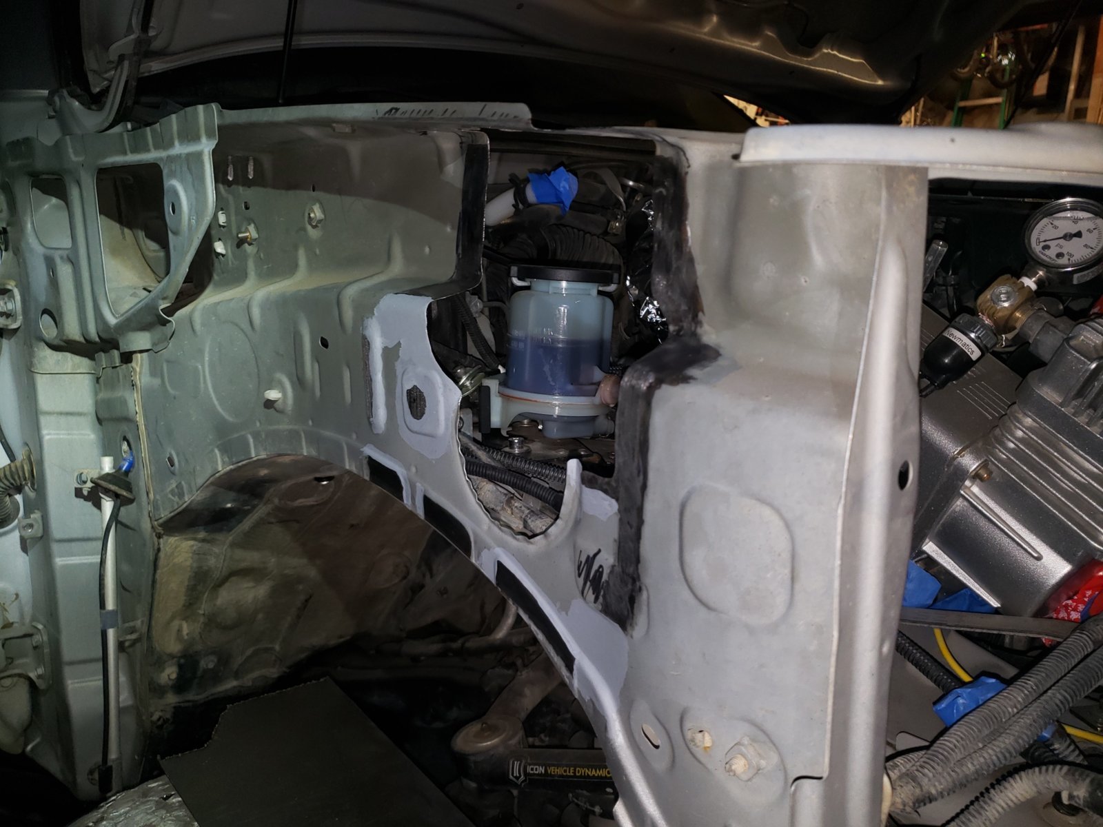

    The grommet is up behind the wheel well liner. Essentially a few inches away from the cowl side entrance. The antenna grommet is like 1” diameter or so, and they’d have to chew it up pretty good to get in that way.

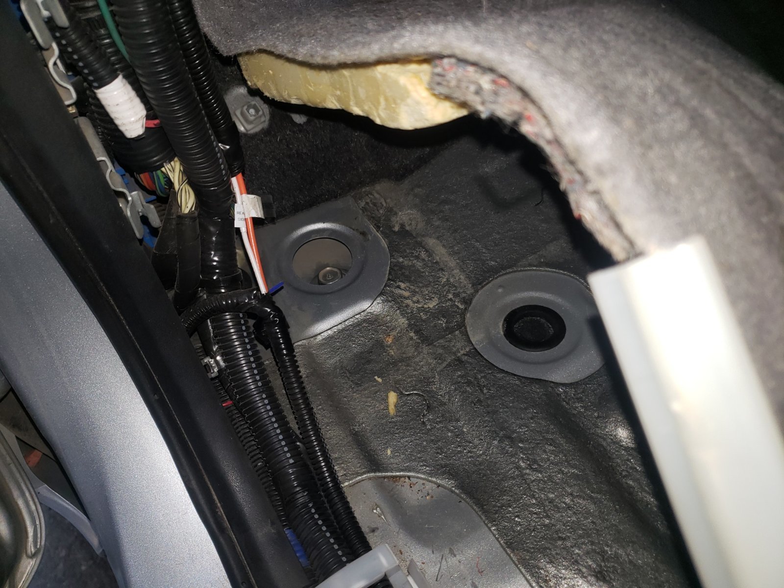

    In addition to the antenna wire... I'd check lower door seals for evidence of them squeezing by. Also you could pull the carpet back from the kick panels, there are plugs over the body mounts, maybe they could get in there? They can push their way through really small openings in the first place, and with rubber seals and such, you might not be able to see the hole.

    And here's some of those plugs in the floorboard:

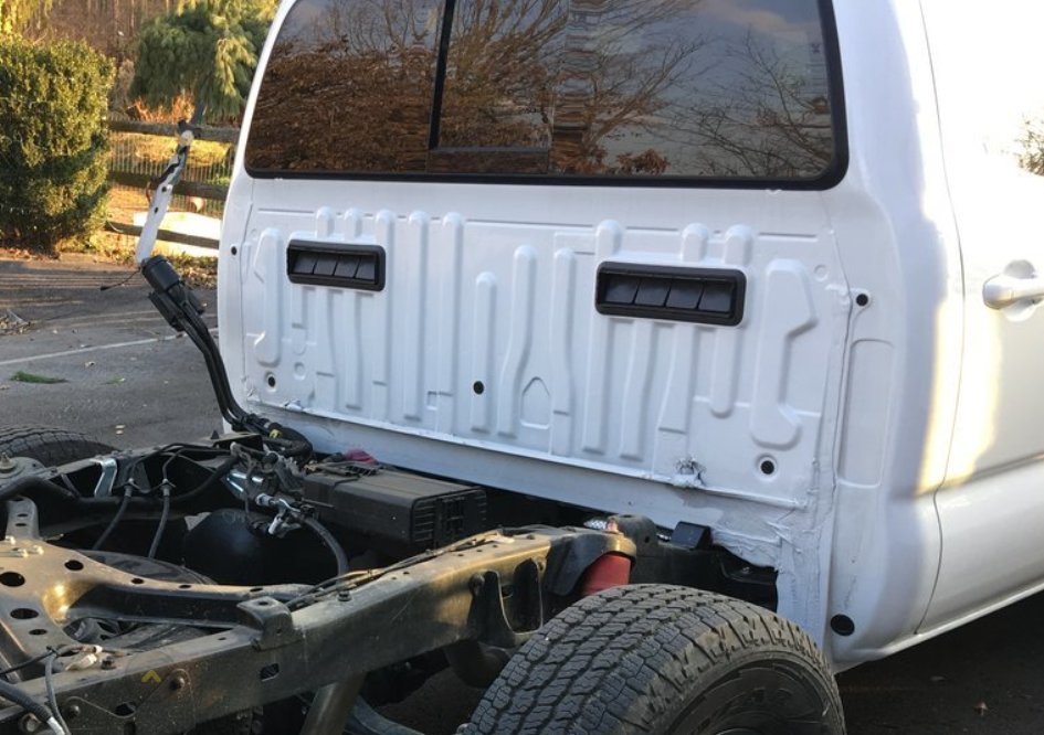

    did you check the hvac vents on the rear of the cab? Plenty of room for them to chew through there. Check behind your rear seats.

    Yes. The vents are used for cab through ventilation when recirc mode is off. All vehicles have them in some form.

    Yes. At least for the access cab- which has one vent at the center. You need to remove the panel at the rear of the cab.
