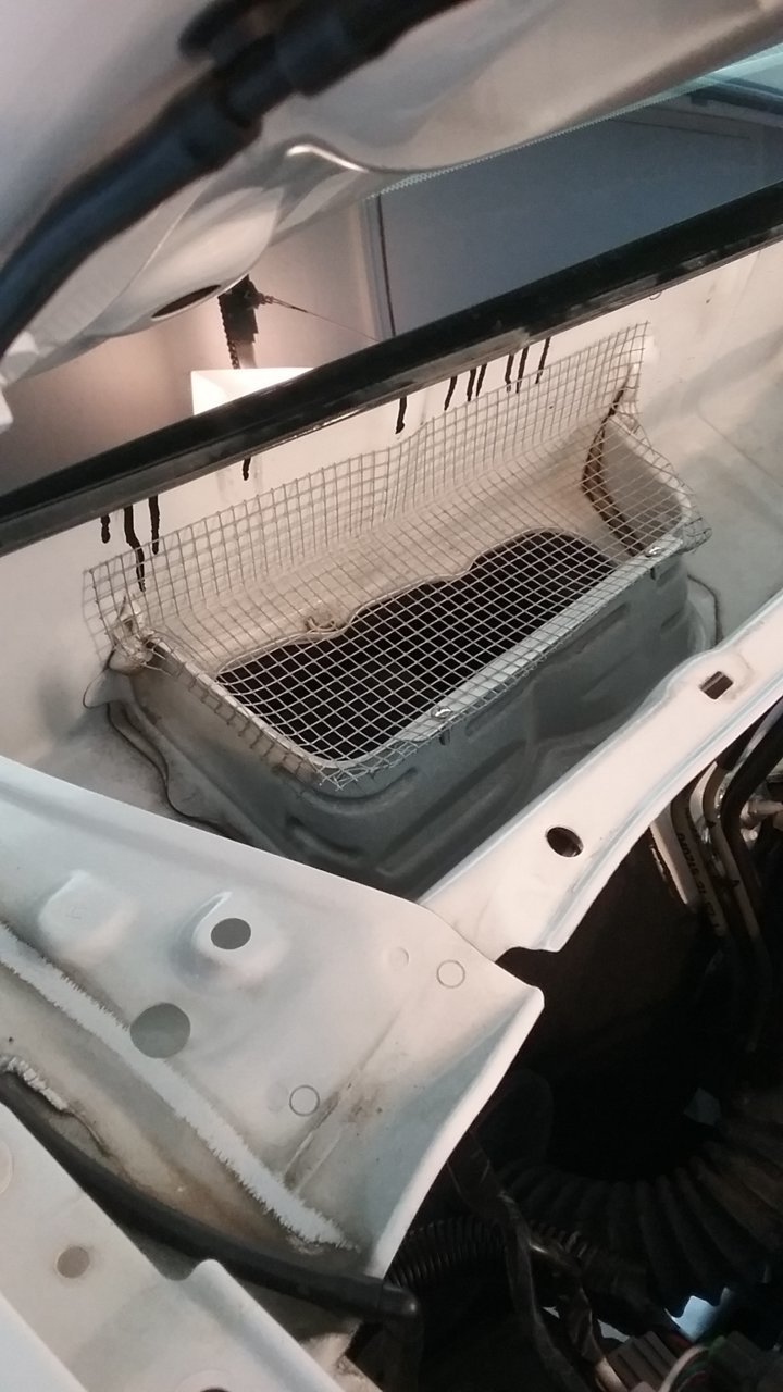

    It is on the 2nd gen. I'm confident it's the same on the 3rd gen. I used some galvanized screen and some stainless steel nuts/bolts to prevent rusting.
    Be sure to mold it very tightly around the opening. I also ran it up the firewall a bit and made it as tight against it as I could. A determined mouse can squeeze through very small openings.

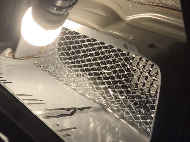

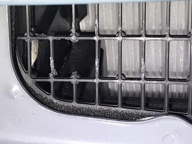

    I pulled my air intake cover off today and there it was! Those little hellyuns chewed right through the plastic vent mesh. Metal mesh incoming....
  18. Nov 22, 2020 at 3:35 PM
    #38
    Greatdane01
    Greatdane01 [OP] Well-Known Member
    Jan 5, 2019
    #278232
    278
    3rd Gen TRD Sport Tacoma
    3” lift, XD Wheels, BFG Tires, GT momentum cold air intake
    They’ll need metal cutting teeth to get in now.
