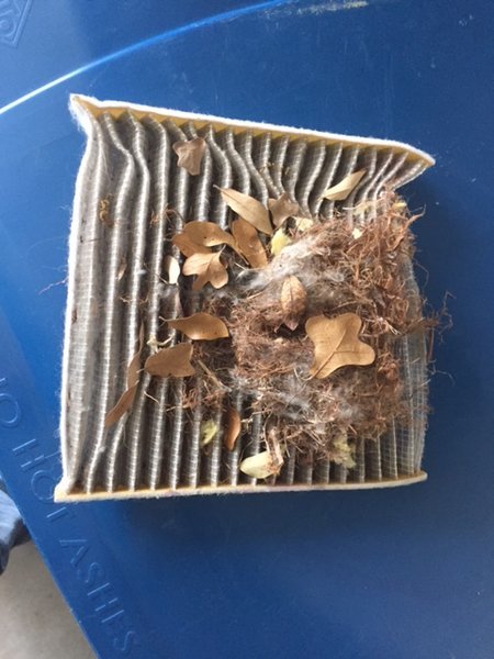

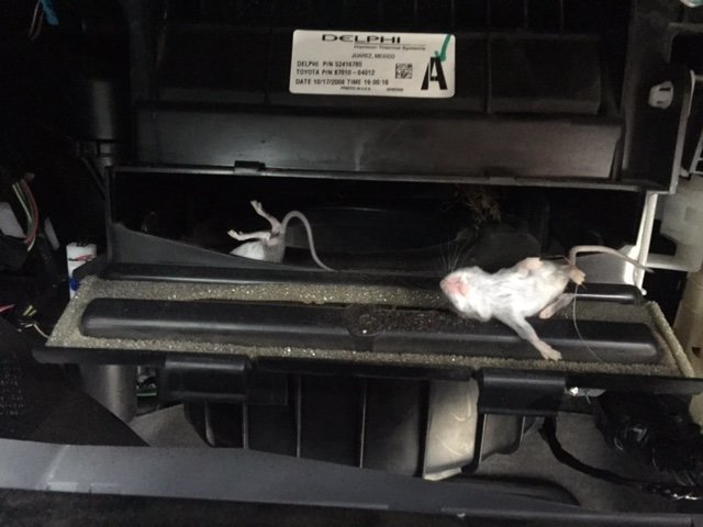

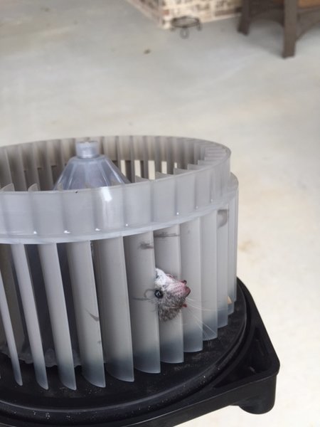

    I returned from a out of town trip and when I turned on my a/c the entire dash started to vibrate and make a loud humming noise. I immediately turned it off, the back on to see if it was really the cause of the vibration. The damn noise and vibration was still there. So I just drive the truck home with the windows down.
    Once I get home I search TacomaWorld to see if anyone else has had a similar experience. As I read, I figured it could be coming from the fan blower motor for a number of reasons. This is what I found:
    To summarize, these four rodents somehow made their way into the truck via the air filter box and started to nest. Once I pulled the fan and filter I discovered them, all having moved on to the afterlife. The vibration was because of an weight imbalance once the motor got up to speed.
    Got it all cleaned up, spritzed it with Fabreez and replaced all the components. Glad I caught it early.

    great pics BTW. It looks like a slaughter...

    Agreed! It looks like one of those old Civil War post battle photos with the dead bodies posed next to a rock wall or tree.
    If it had been me, I would have been too pissed to take any pics.
