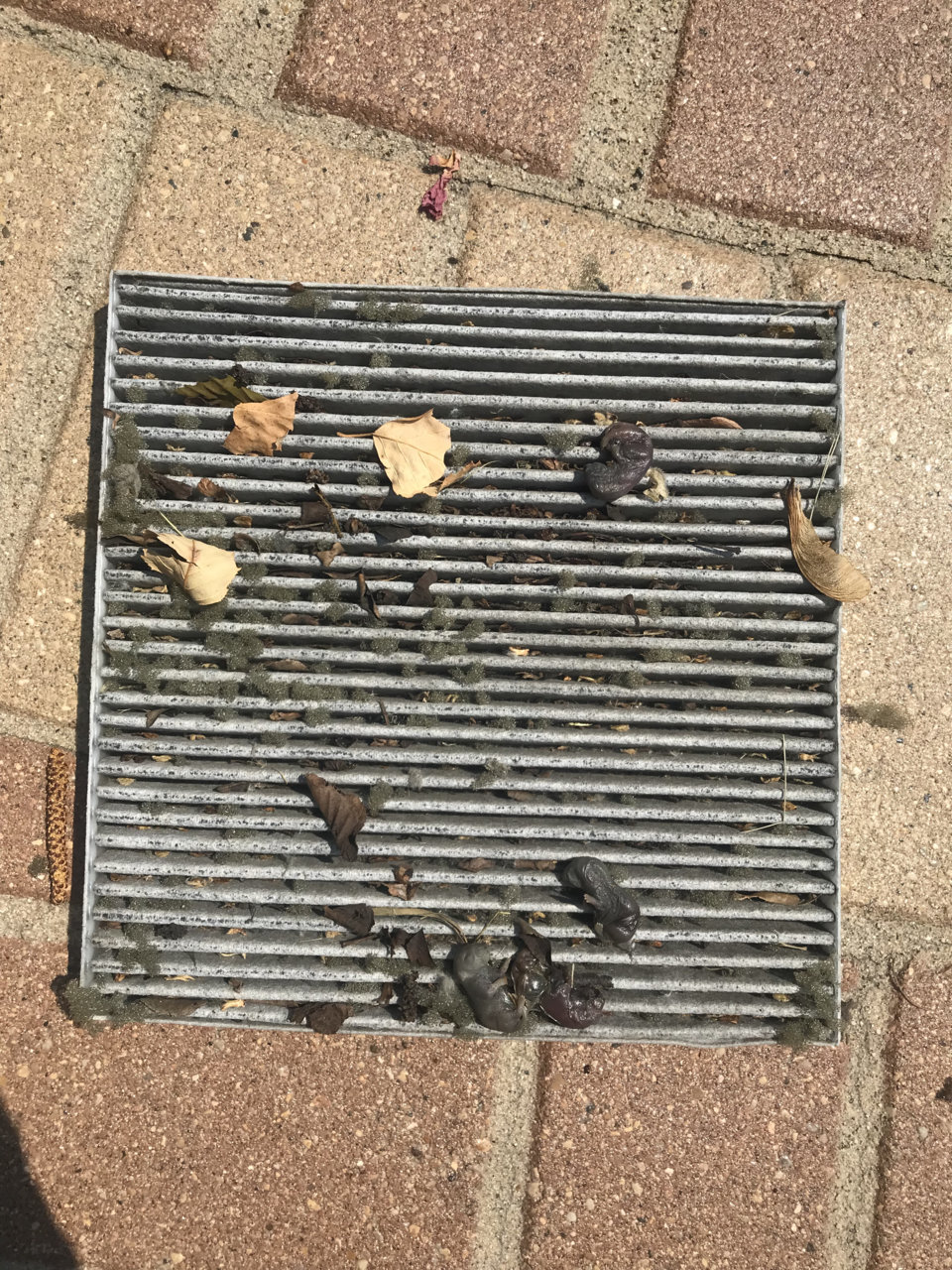

    I found this on my cabin filter.
    Inserted the vacuum hose and cleaned inside the vent. Where should I look under the hood to see where they might came in?
    Any way to prevent it?
    I park my truck on my driveway in the summer and in the garage during winters.
    Thanks

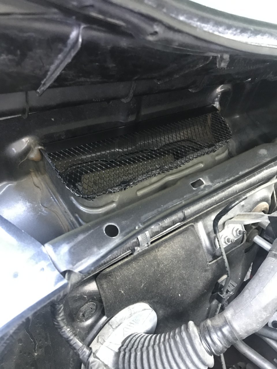

    Thru the cowl vent... Attach some 1/4" mesh

    Seriously, the wire over the cowl intake is merely a small obstacle. Mice can pass through a 1/4" gap. So, 1/4" x 1/4" hardware cloth is only a bother. Sure, the hardware cloth will prevent bigger critters from making a home, but not the mice.
