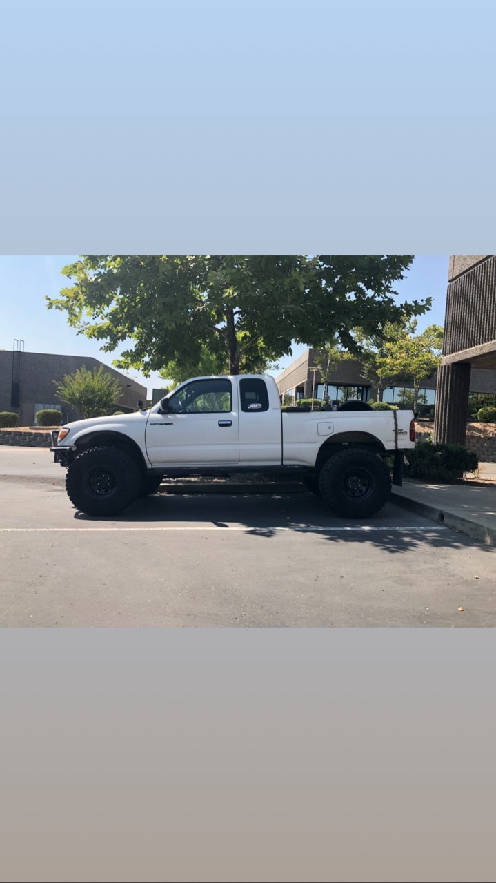

    My name is Michael, I bought my tacoma in 2014 to daily drive for college. It had about 270,000 miles on it when I got it and it was completely bone stock.
    Modifications
    Marlin crawler crawl box 4.70
    Inchworm adapters
    Suspension
    Bilstein 5100s on Eibach coils (old)
    Rear Bilstein 5100s
    Wheelers leaf pack
    Camburg upper control arms
    Donahoe racing coilovers
    Extended rear brake line
    BAMF BPV bracket
    Wheelers bumpstops
    Armor
    BAMF rock sliders with kickout
    All pro Front bumper
    All pro IFS skidplate
    All pro transmission skidplate
    Custom high clearance bumper
    Tires and Wheels
    33x12.5x15 Cooper discoverer stt pros (old)
    35x12.5x15 Cooper Discoverer stt pros
    Pro comp 15 inch black steel rims
    Interior
    Alpine 12 inch type S subwoofer
    Alpine type S speakers
    JVC Headunit
    Uniden 510xl Cb radio
    Grey wire mod
    Exterior
    Bobbed bed 10 inches
    Custom spare tire mount
    60 inch Hi lift jack
    Shovel and axe
    Cb antenna on custom tire mount
    Tubbed fire walls
    Diff breather to gas fill cap
    Poison spyder 3 way tire strap
    Recovery
    Smittybuilt 9500 winch
    Tow ropes

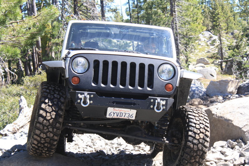

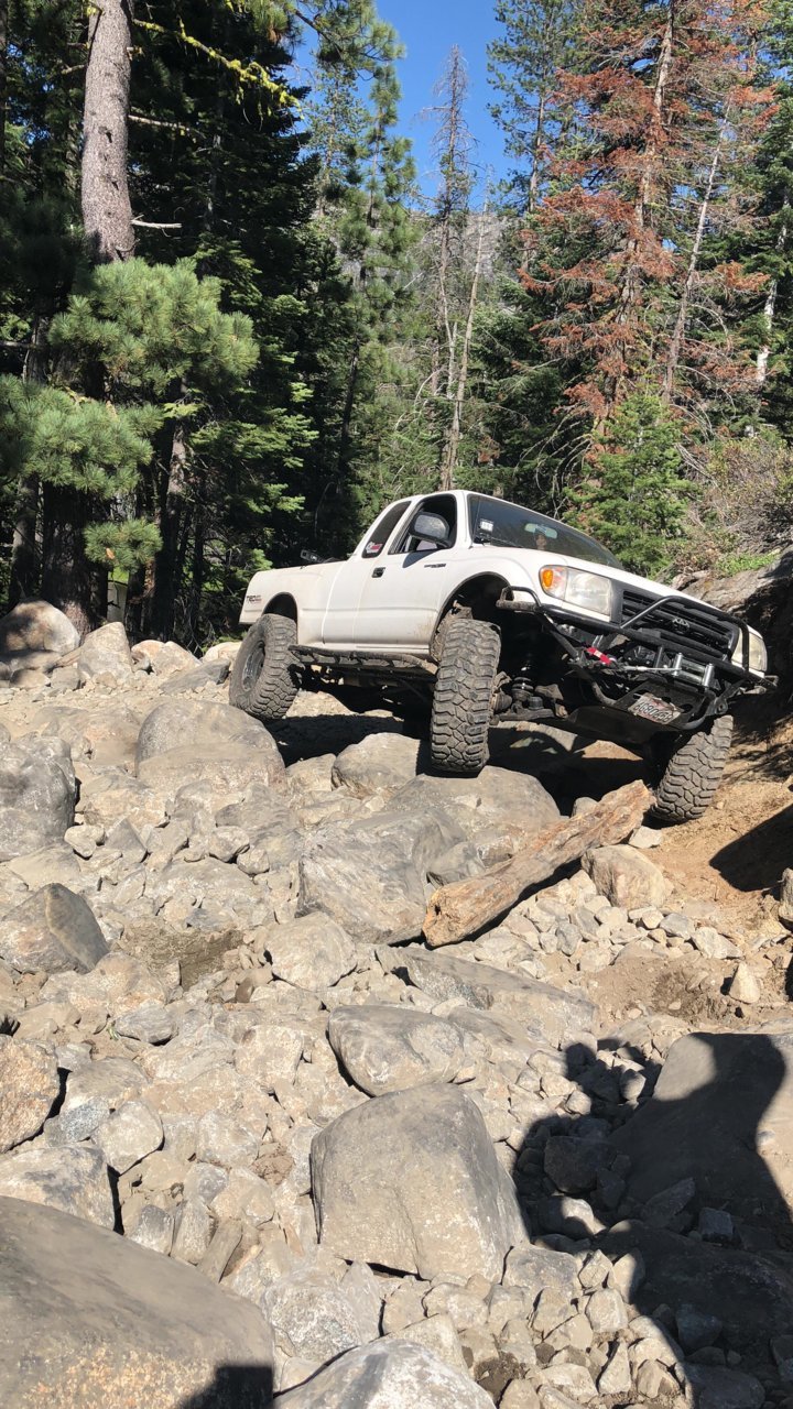

    Nothing new with the tacoma but I was able to run some of the rubicon this past weekend on the poker run with my dad in his jeep.

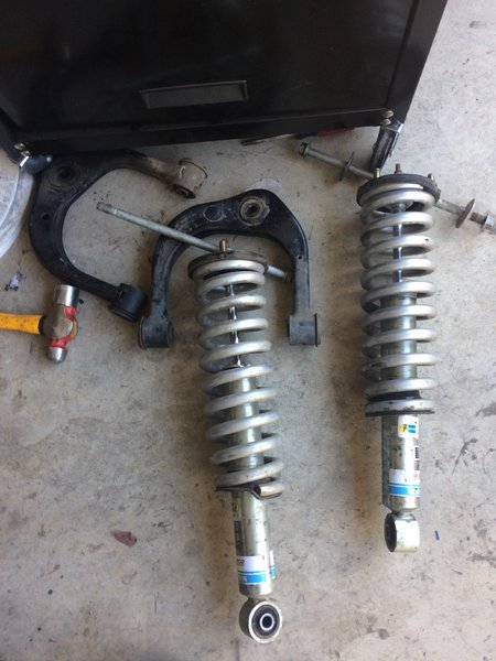

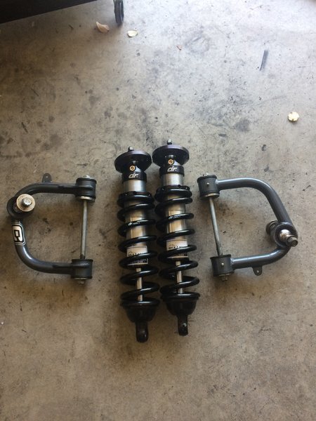

    Gonna be throwing these on this weekend. Picked up these donahoe racing coilovers about two months ago they just got a full rebuild at rock and road performance with all new icon parts. Also have a set of Camburg upper control arms to put on as well.

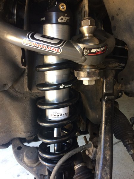

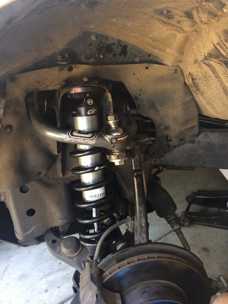

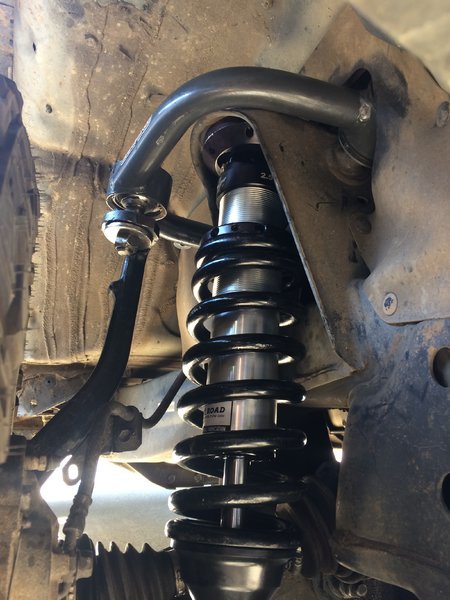

    Finally had some free time to throw on my camburg upper control arms and a set of freshly rebuilt Donahoe racing upper control arms.

    It's hard to tell in the pic, but make sure you have a snap-ring on the topside of the uniball adapter that presses into the spindle/knuckle. Also flip the orientation of the 5/8 bolt going through the uniball so you have more clearance with the head of the bolt being thinner than the stover lock nut.

    Thanks for the advice. Took the picture before I had the snap ring in yet. And I'll make sure to flip that bolt around!

    Front looks a bit low. Did you crank those bad boys down yet??

    I hadn't lifted them up yet in the picture I actually just rolled it out the garage. I have raised it back up to clear the tires now.
