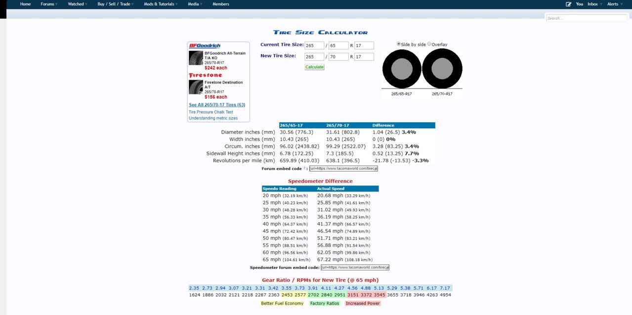

    Your truck comes stock with a 265 65 17 and you are moving up to a 265 70 17. The width of 265 is the same on each tire so no way they can rub on the upper control arm. I'm calling bs on whatever shop you took the truck too! All you changed was the height of the tire not the width!
