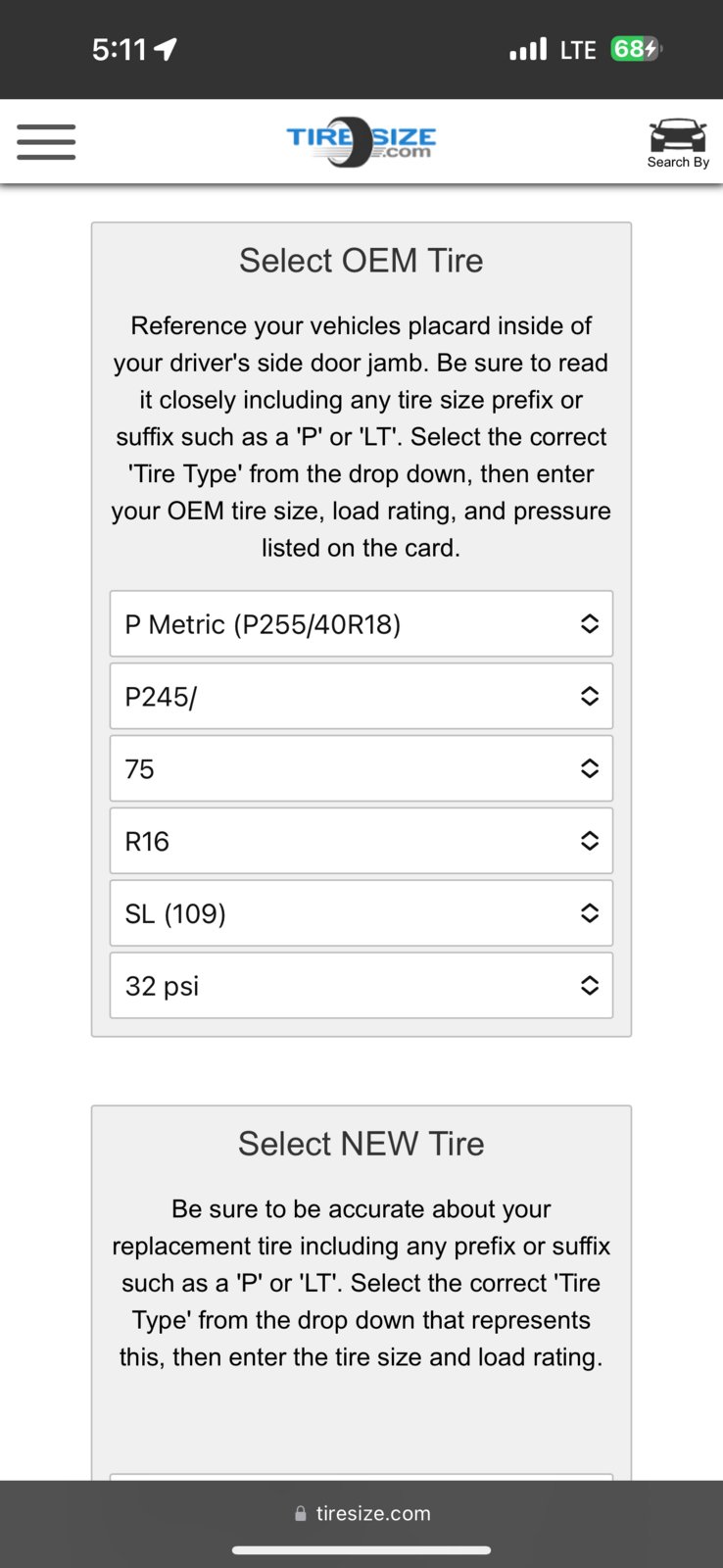

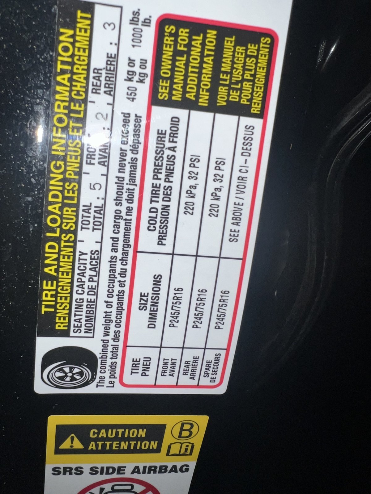

  16. Nov 30, 2023 at 2:40 PM
    #16
    BLtheP
    BLtheP Constantly Tinkering Member
    Apr 5, 2022
    #394355
    4,625
    Plano, TX
    2021 MGM TRD On-Road DCSB MT
    RC60F Transmission ADD delete with FJ full-time tube FJ Metal Clutch Pedal OEM Mexico-Spec Condenser Fan 265/70R16 Michelin Defender LTX M/S 2 OEM 1-Piece Lug Nuts Custom Built Switch Panel for all Electrical Accessories Rigid Amber Pro D-SS Ditch Lights Rigid 30" SAE High Beam Driving Light Bar Rigid SR-Q Pro Back-Up Light Kit (Recessed) VLEDS Tail Conversion VLEDS Foot Well Light Kit KC HiLites Cyclone V2 Under Hood Lights Operable (Switched) Clutch Safety Bypass
    Start with one of the stock tires. It matters if it's a P-metric or euro metric. Euro metric is metric that is NOT LT and doesn't have the P in front, aka 265/70R16. I'm not sure what the stock tire on your SR5 is - I know it's either P245/75R16 or 245/75R16. You'd enter that into the website.
    Then for the new tire, you'd choose euro metric (because I know Michelin 255/75R17 is only euro metric and not P or LT), then enter the 255/75 info and it should spit out 27.
    Hauser94[OP] likes this.
