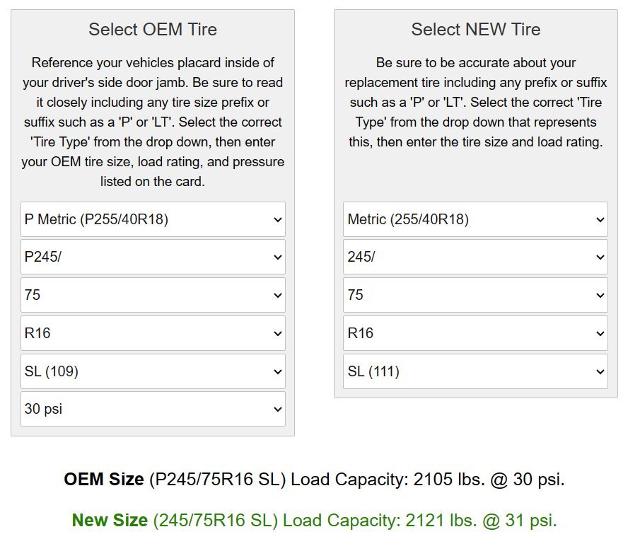

    NorthWitaco
    NorthWitaco Well-Known Member
    Aug 20, 2023
    #431703
    62
    2014 access cab 4wd
    I'm a little confused. Using the tire calculator it says that my stock tire size is 245/75 R16, when the door panel says that it is P245/75R16 is there a difference between the two?

    There is a difference. P-metric and non-P (euro metric) have different load capacities given a certain tire pressure and they have different minimum and possibly maximum pressures.
    How is the calculator telling you what you have? You have to put in the info yourself, from what I’ve seen. Part of that is choosing p-metric or euro metric.

    NorthWitaco
    Aug 20, 2023
    #431703
    62
    2014 access cab 4wd
    My bad, I was using the tire Pressure Calculator. The pressure calculator is telling me that my stock tire is 245/R16, when the door panel says that it is P245....

    If it's missing the P, it's incorrect. What's on the sticker is right.

    NorthWitaco
    Aug 20, 2023
    #431703
    62
    2014 access cab 4wd
    I have 245/R16 on my truck now, I was just checking on what pressure my tires should be?

    BLtheP
    BLtheP Constantly Tinkering Member
    Apr 5, 2022
    #394355
    4,645
    Plano, TX
    2021 MGM TRD On-Road DCSB MT
    RC60F Transmission ADD delete with FJ full-time tube FJ Metal Clutch Pedal OEM Mexico-Spec Condenser Fan 265/70R16 Michelin Defender LTX M/S 2 OEM 1-Piece Lug Nuts Custom Built Switch Panel for all Electrical Accessories Rigid Amber Pro D-SS Ditch Lights Rigid 30" SAE High Beam Driving Light Bar Rigid SR-Q Pro Back-Up Light Kit (Recessed) VLEDS Tail Conversion VLEDS Foot Well Light Kit KC HiLites Cyclone V2 Under Hood Lights Operable (Switched) Clutch Safety Bypass
    Factory pressure was 32 F/R and P245/75R16?

    NorthWitaco
    Aug 20, 2023
    #431703
    62
    2014 access cab 4wd
    Door panel says 30# F/R P245/R16

    BLtheP
    Apr 5, 2022
    #394355
    4,645
    Plano, TX
    31PSI for 245/75R16.

    NorthWitaco
    Aug 20, 2023
    #431703
    62
    2014 access cab 4wd
    Thank you, Sir, for your help. Now I have another question. I tow a camper with a tongue weight of approximately 400 lbs. and 300 in the box. Should I boost the pressure a bit to say 35#?
    Apr 5, 2022
    #394355
    4,645
    Plano, TX
    Not a bad idea. I don't know if it will matter, but it won't hurt.

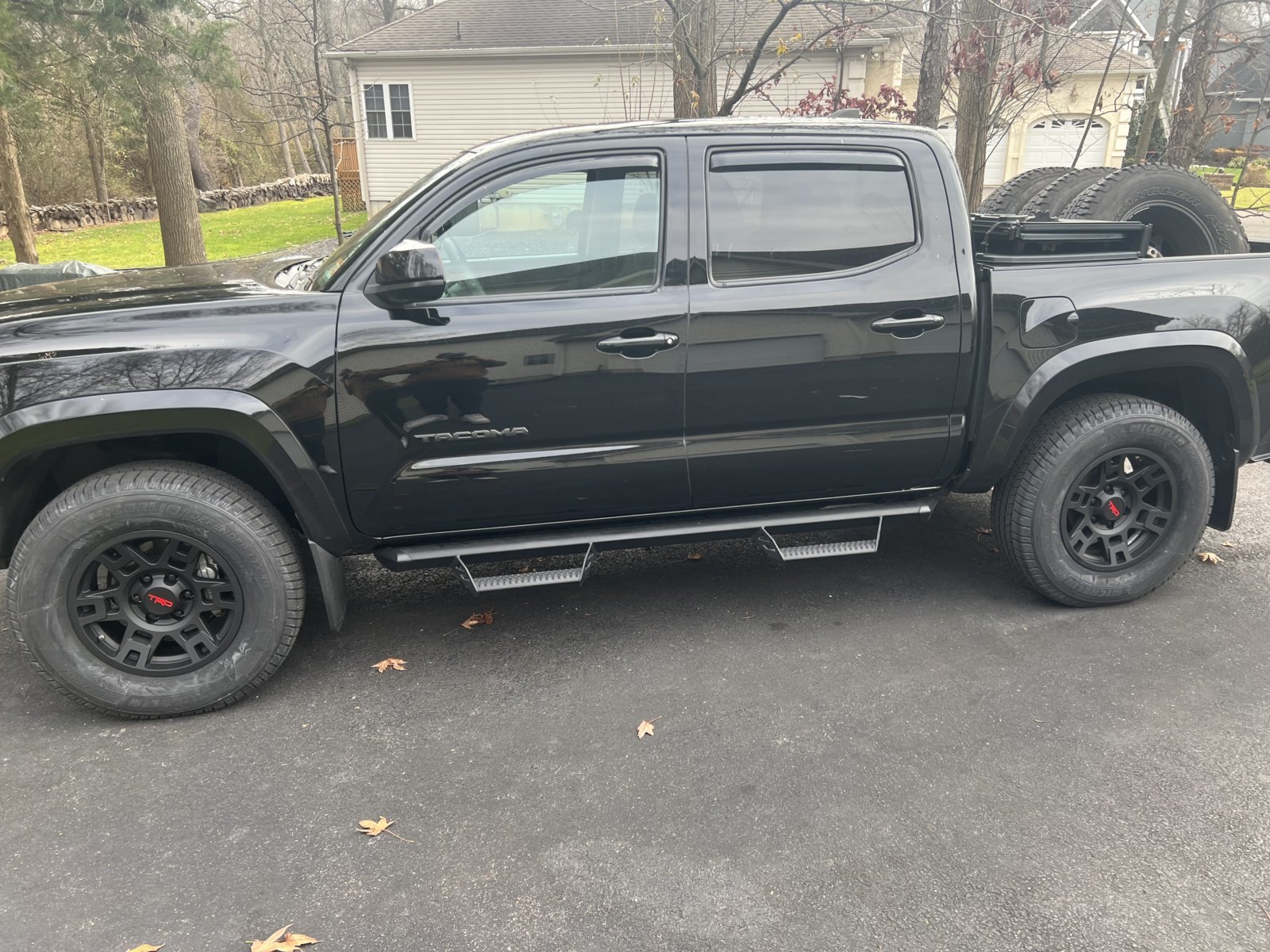

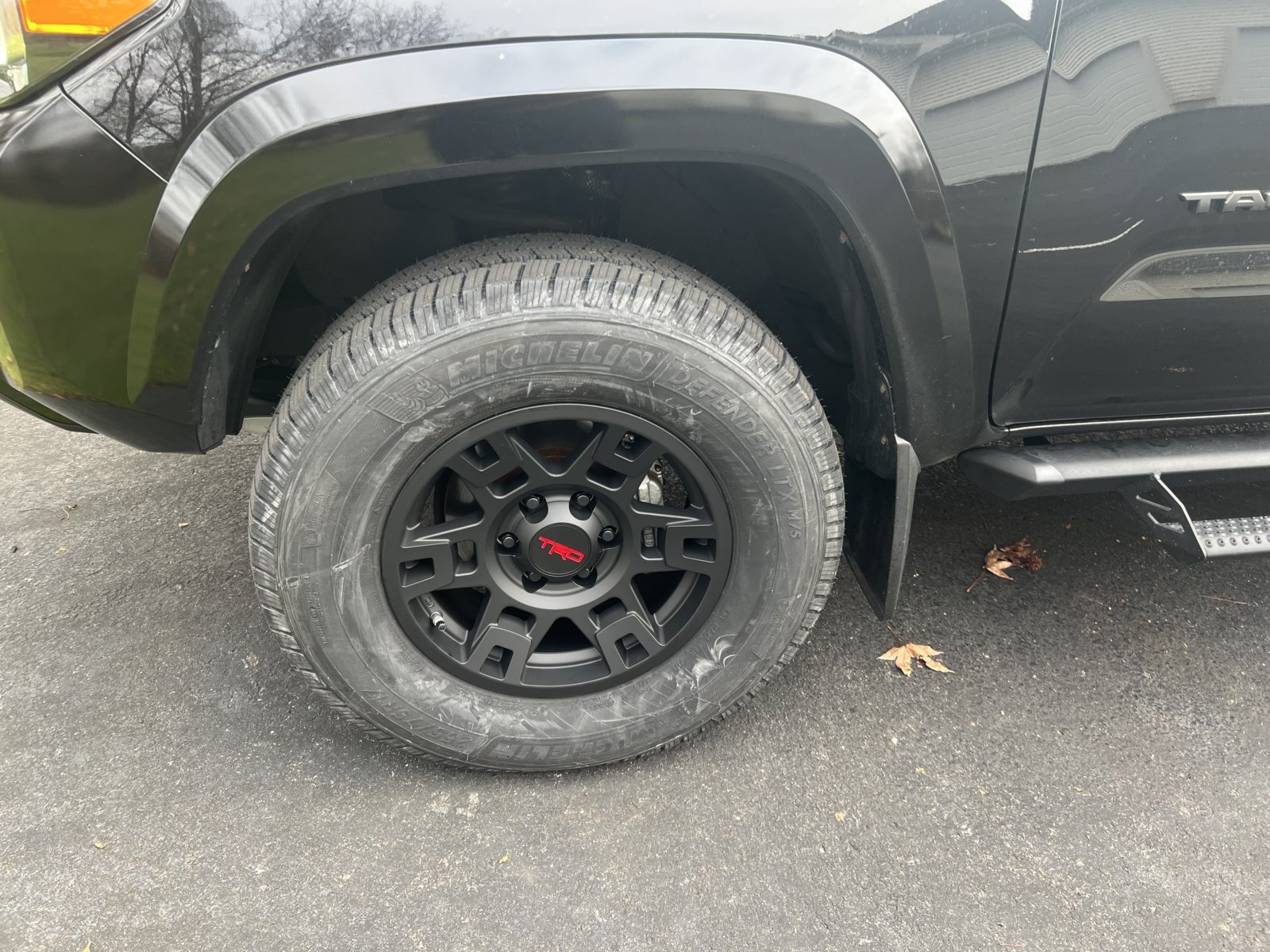

    Hauser94
    Hauser94 [OP] Well-Known Member
    Nov 21, 2022
    #411191
    336
    2016 Black Tacoma SR5 DCSB
    Alright all done, bouta throw on this dr beasley matte seal and call it a day. Love the look. And man are them tires grippy
