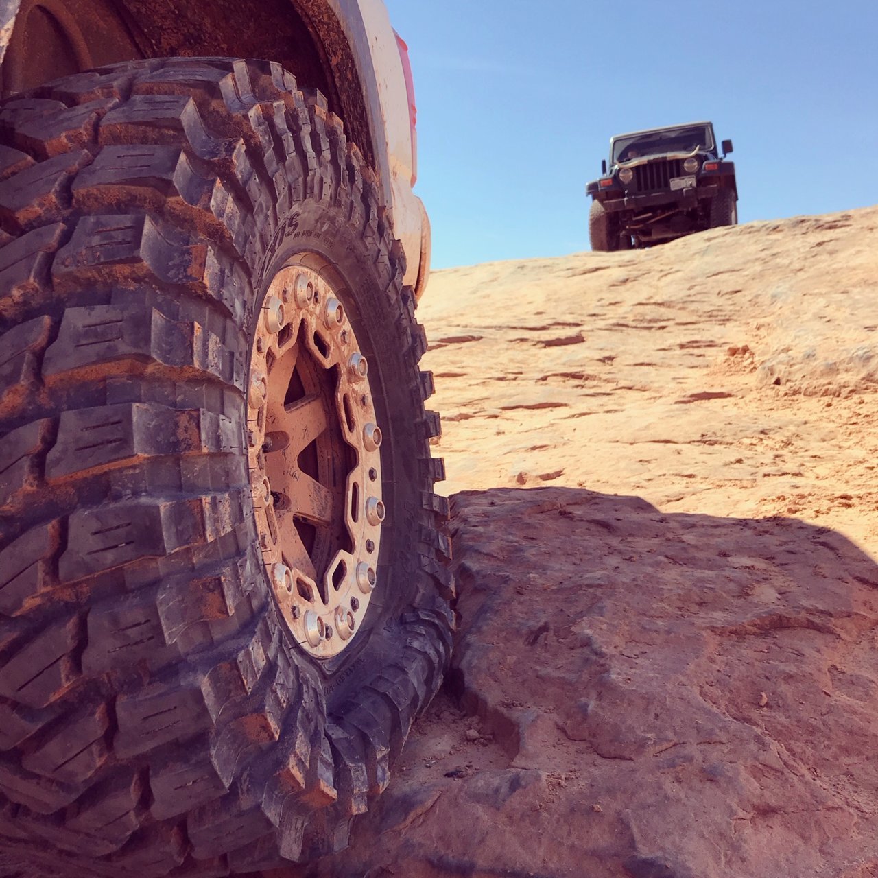

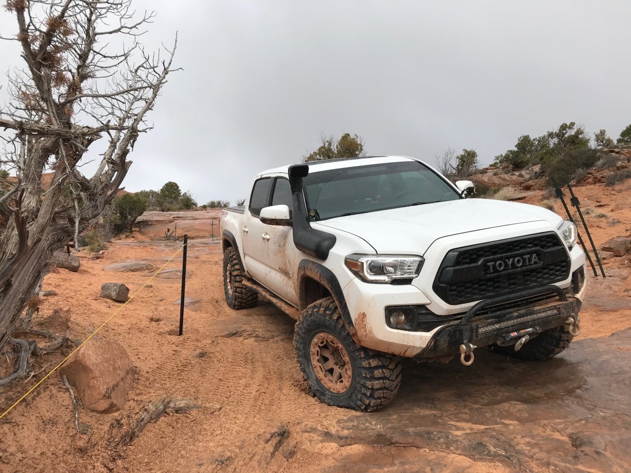

    What kind of pictures do you want to see?
    When I had my sidewall puncture I had to use the super swamper I'd been given for a spare. Did lots of wheeling in Moab with 3 michelins and the swamper. It's one of the most aggresive looking tires I've ever seen short of a paddle tire for mudding. Made a tremendous racket on the road and threatened to rattle your fillings loose. Guess which tire consistently broke loose on any type of terrain?
    I'm trying to help OP. People telling him that he can't offroad a great tire because it doesn't look cool doesn't seem terribly helpful.
    I've wheeled a lot of different places with a lot of different people who ran a lot of different tires. I never found the terrain that I couldn't traverse but someone with a similarly set up truck could with different tires.
    Anywhere this truck can go, the michelins can take you. 100,000 mile tread life and great traction on wet or snowy roads with an incredibly smooth and quiet ride to boot makes it better than any other tire I've ever come across.
    I'm currently running cooper st maxx, a very popular aggressive looking tire. I'm running them because they quit making the michelins in my size. They're not a bad tire by any means. Seem to do just fine off road. Not very good traction on icy or snowy roads. Ride rougher than the michelins. Tread life is maybe 1/3 of the michelins.
    I have a set of 17" rims so that I can go back.

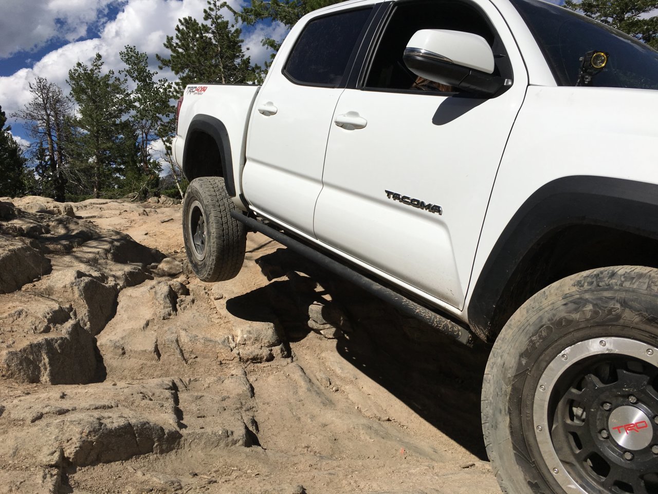

    I guess I'll take the time to write out an explanation. The full explanation will be long though... maybe too long to read.
    I didn't buy Michelins because I wanted to go wheeling. I went wheeling with Michelins because they were what I had. They were what I had because of the incredible experience I've had with them. I owned a Ranger before this Tacoma. I never modded or wheeled the Ranger other than fire roads. I had 80k miles on it when I had to buy my first set of tires (factory Firestones were recalled and replaced with some other garbage) I decided that I would spend some money on a decent set of tires and got the Michelin LTX M/S. It was like a brand new vehicle. The ride was amazingly better than before. They had way better traction on winter snow packed roads too. I figured that to perform as well as they did, they must be soft and wear quickly or something. I sold the Ranger at 198k miles with those same tires on it. They were so old that the sidewalls were checkering from dry rot but they still had adequate tread and still performed well in rain and snow.
    Enter the Tacoma.... I wanted to mod and wheel the Taco. I read up and researched on TW and realized I needed to get different wheels or spacers to run 33s. I found a set of wheels with the right specs on craigslist and they were coincidentally wrapped in Michelin LTX M/S tires. Same deal... it felt like a brand new truck because it rode so much better. I honestly feel like the manufacturers are short changing themselves when they put crappy tires on their new vehicles. A test ride would be much more impressive on good tires than the ones they ship them out with.
    Not being made of money, I started wheeling with a cheap bilstein lift and these old michelins. I was surprised at what the Tacoma would do. It seemed much more capable than the full size Fords and Chevy's I remembered from high school. (Still miss my '69 Bronco though). I met a lot of good people here on TW and was led around on a lot of cool trails. Everyone laughed at the michelins and it kind of became a running joke. I got crap for my tires, but I followed right along on the same trails that everyone else was running. I enjoyed the wheeling so much that if I had ever found the tires lacking, I definitely would have bought something else. But I didn't. To this day, I have not gone anywhere where a similarly equipped truck with different tires had any less difficulty on anything that I did and the people I've gone wheeling with will acknowledge this. It's still a running joke and we've had a lot of fun with it over the years. I didn't give myself my title or make the picture in my signature. Those were done by people that have gone wheeling with me. I did post this for fun...
    and things like this....
    Everyone is going to have an opinion. Especially about tires. They're almost as bad as oil. We have a lot of fun with opinions but don't let someone mix those up with facts. Don't let someone tell you you can't air them down. I've aired down to 8psi for sand dunes and regularly down to 12-15 for most trails. Don't let someone tell you they have weak sidewalls. While I have punctured one, I've also subjected them to a lot and I don't think I've seen a make or model of tire that I haven't seen someone puncture. And definitely don't let someone tell you they aren't any good offroad. It just isn't true. There were some concerned jeepers in Moab once who asked my friends if the "the guy with the highway tires was going to be alright" and then were amazed when I walked up the "tipover challenge" that they couldn't do. (It's really more about wheel base)
    There are definitely people with more radically built trucks. 35s would be a jump up from the 33s I'm running and would open up tougher trails. SAS or Long travel would do the same. I'm not there yet and likely won't be at least as long as the Taco is my daily. I'm ok with that, I get to go everywhere I want to and experience what I want to the way she sits now and I honestly believe that I've pushed the limits of what an IFS Tacoma can do on 33s. Never did I feel that the tires were holding me back in any way.
    The used tires were doing the whole dry rot/checkered sidewall thing too. I think they were about 10 years old or so if I remember from the date stamp. When I finally decided to get new tires, I was so sold on the Michelins that I didn't want anything else. I did decide to try the A/T 2s. They're marketed as ATs I guess, but really the only noticeable difference is that they scallop out some of the outside of the tread. I can't honestly say it's made any difference in offroad performance. Fortunately, they were every bit as good as the M/S were in terms of ride and wet/icy road performance. They may not have gotten quite as good mileage, but I can't be sure because 1) different truck and 2) when they were about 3/4 worn, I got the sidewall puncture outside of Moab somewhere. It was a sad day when I found out that the 285/75/16s were discontinued in the A/T 2s and I'd have to get new tires. I finally settled on the Cooper ST Maxx tires and I've been disappointed ever since. I've done some wheeling with them and they seem to perform the same but there are some pretty big sacrifices on road. Ride quality is rougher and noisier, wet/icy performance is not even close and (fortunately?) the wear is a mere fraction of what the Michelins were giving. I say fortunately because I've gotten a hold of some 17" wheels and I'm really looking forward to going back to the Michelins. These Coopers will not make it to this next winter.
