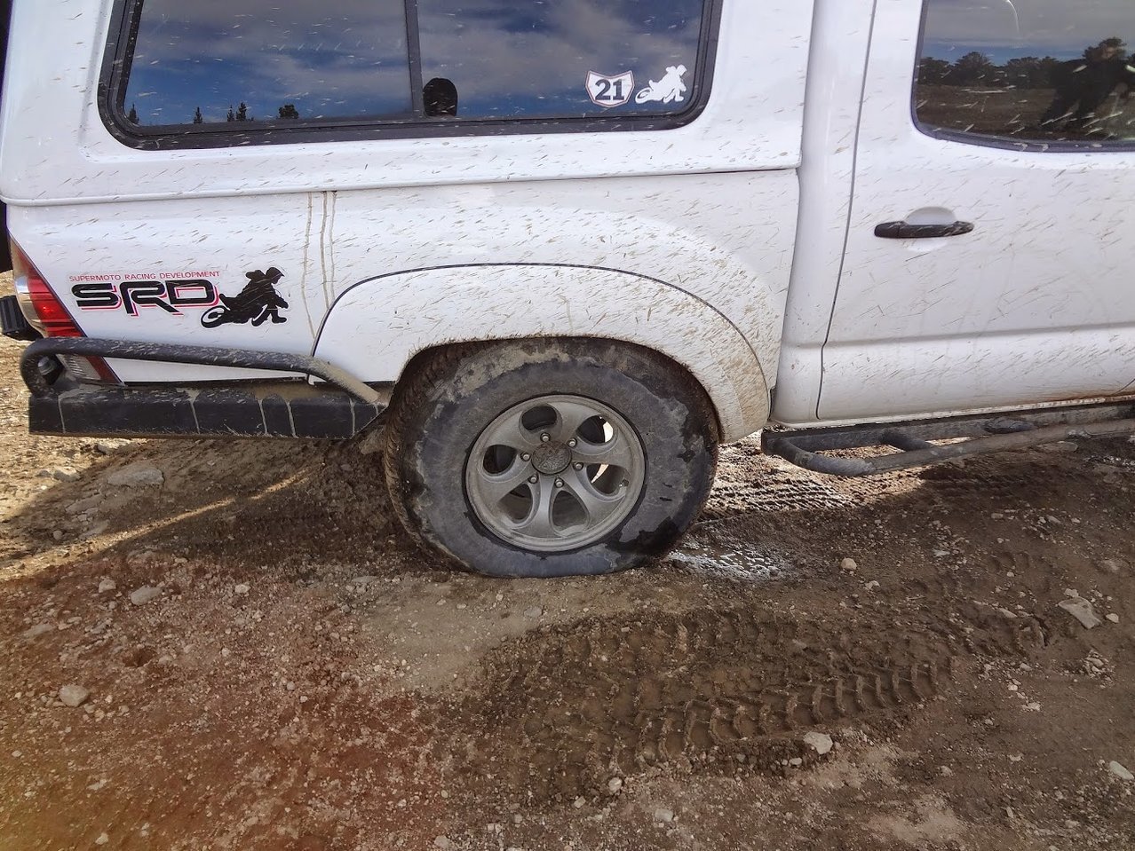

    The michelins ride so plush that I don't see any real "harshening" of the ride. I do it for decreased rolling resistance/better gas mileage.
    I haven't noticed any greater wear in the center of the tire so it works for me. I drop them to 12psi offroad. Only air back up to 30 until I get home to my real compressor.
    ~60k miles
    Squished offroad

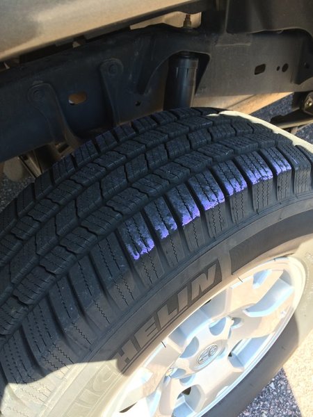

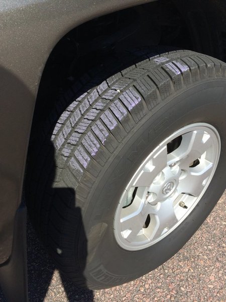

    I just did the chalk rest at 36psi x4. Rears are riding just a little bit high. You can see that there is some chalk left on the outer edge. With just a little weight in the back they would very likely wear evenly. But since I am empty most of the time, I will drop them a pound because they will expand with heat from from drive time.
    The fronts appear to be riding evenly all the way across. As the fronts will heat up more than the rears due to friction from turns and additional weight, I'm inclined to drop a pound as well. But I'm not sure the added pressure from heat will be enough to overcome the additional weight of the front end. So I'm going to leave them for now.
    Any thoughts?
