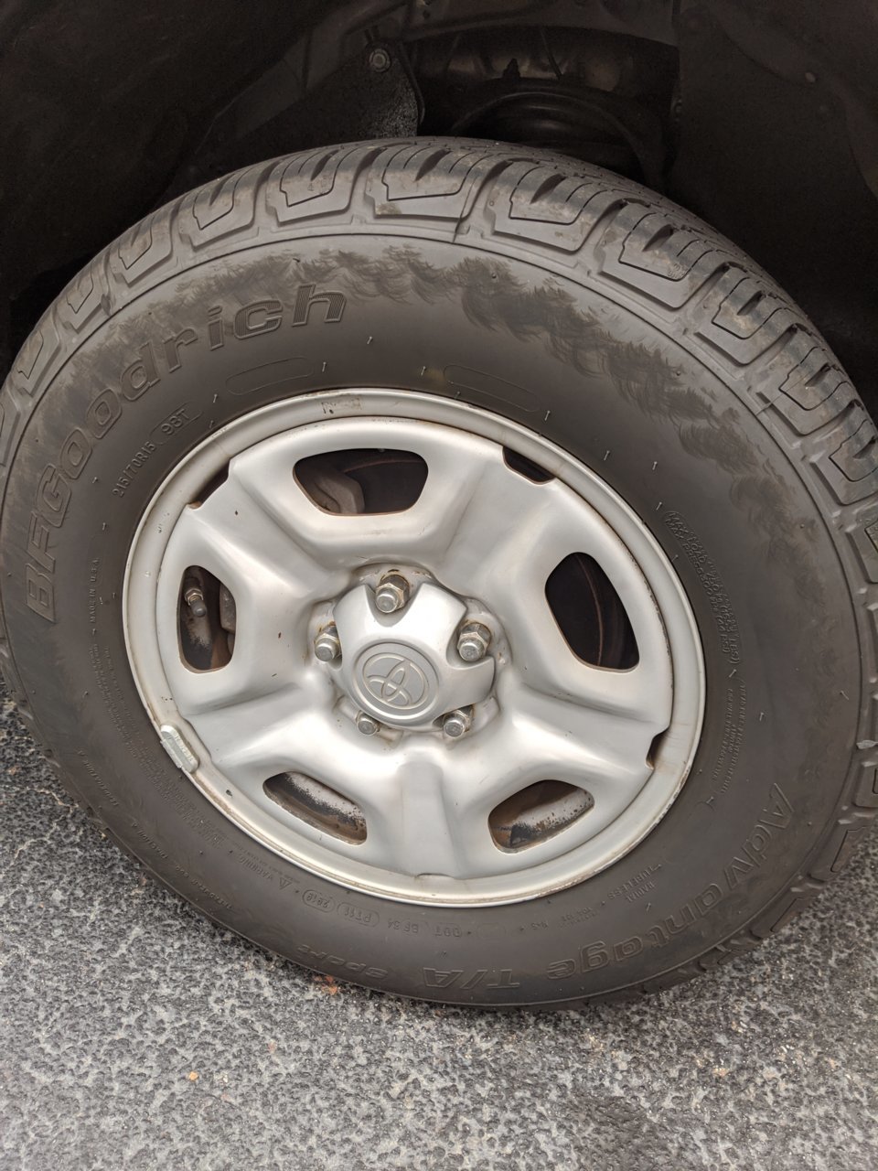

    BFG (now owned by Michelin) Advantage T/A Sport. Mine are 215/70r15. And yeah, sidewall wear. My mother drives this truck, I swear!
    It's been a reliable street tire, and does well in the rain. I don't have to pull over when the weather does.. what it does here. You'll be looking at the UTQG rating for life expectancy. These ratings are manufacturer specific, so the value you take from is that a higher number = longer lifespan, realizing that traction is actually (though companies are working on shrinking this gap) a trade-off with longevity. Balance the two to suit your needs, but I'd ask yuh to prioritize traction as much as can. Saves lives or whatever.
    Specifications
    BFGOODRICH
    ADVANTAGE T/A SPORT (T-SPEED RATED)
    • Size:215/70R15
    • Service Description:98T
    • Load Range:SL
    • UTQG:600 A A
    • Max Load:1,709 lbs
    • Max Inflation Pressure:44 psi
    • Tread Depth:9.5/32"
    • Tire Weight:25 lbs
    • Rim Width Range:5.5-7"
    • Measured Rim Width:6.5"
    • Section Width:8.7"
    • Tread Width:6.5"
    • Overall Diameter:26.8"
    • Revolutions Per Mile:774
    • Country of Origin:UNITED STATES OF AMERICA
