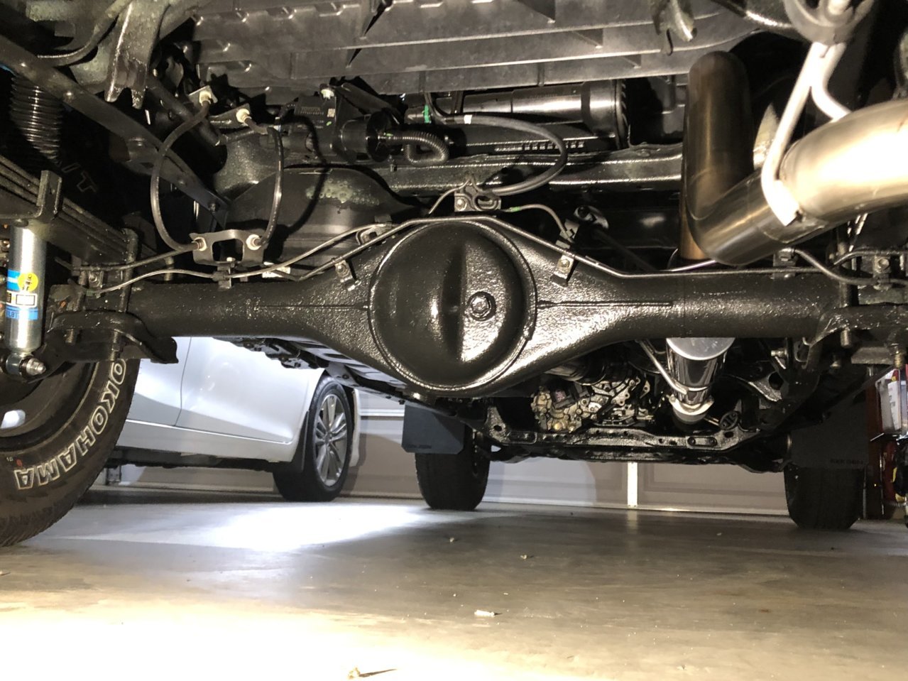

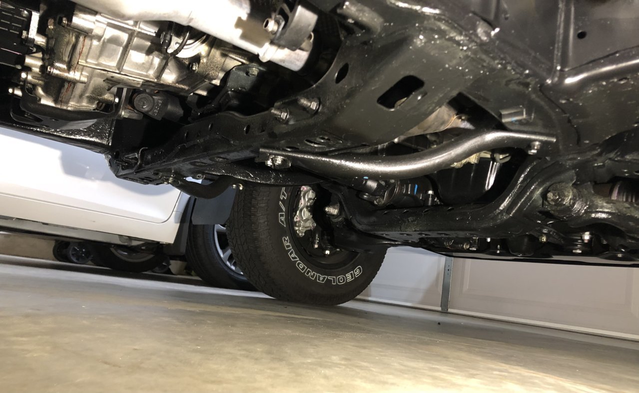

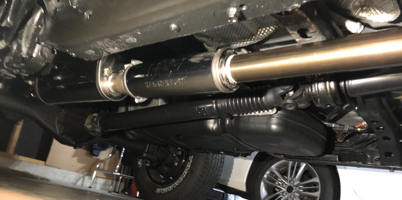

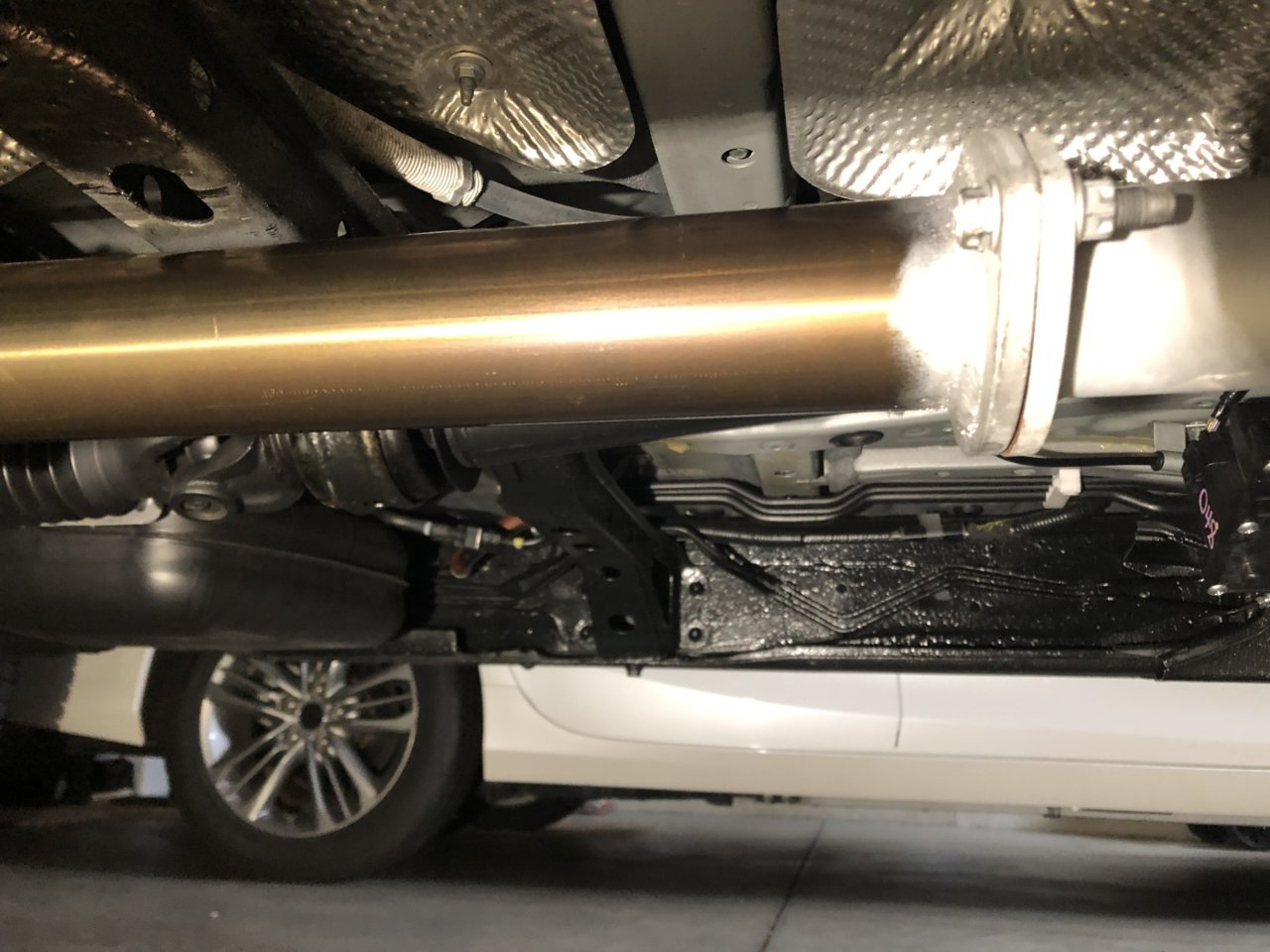

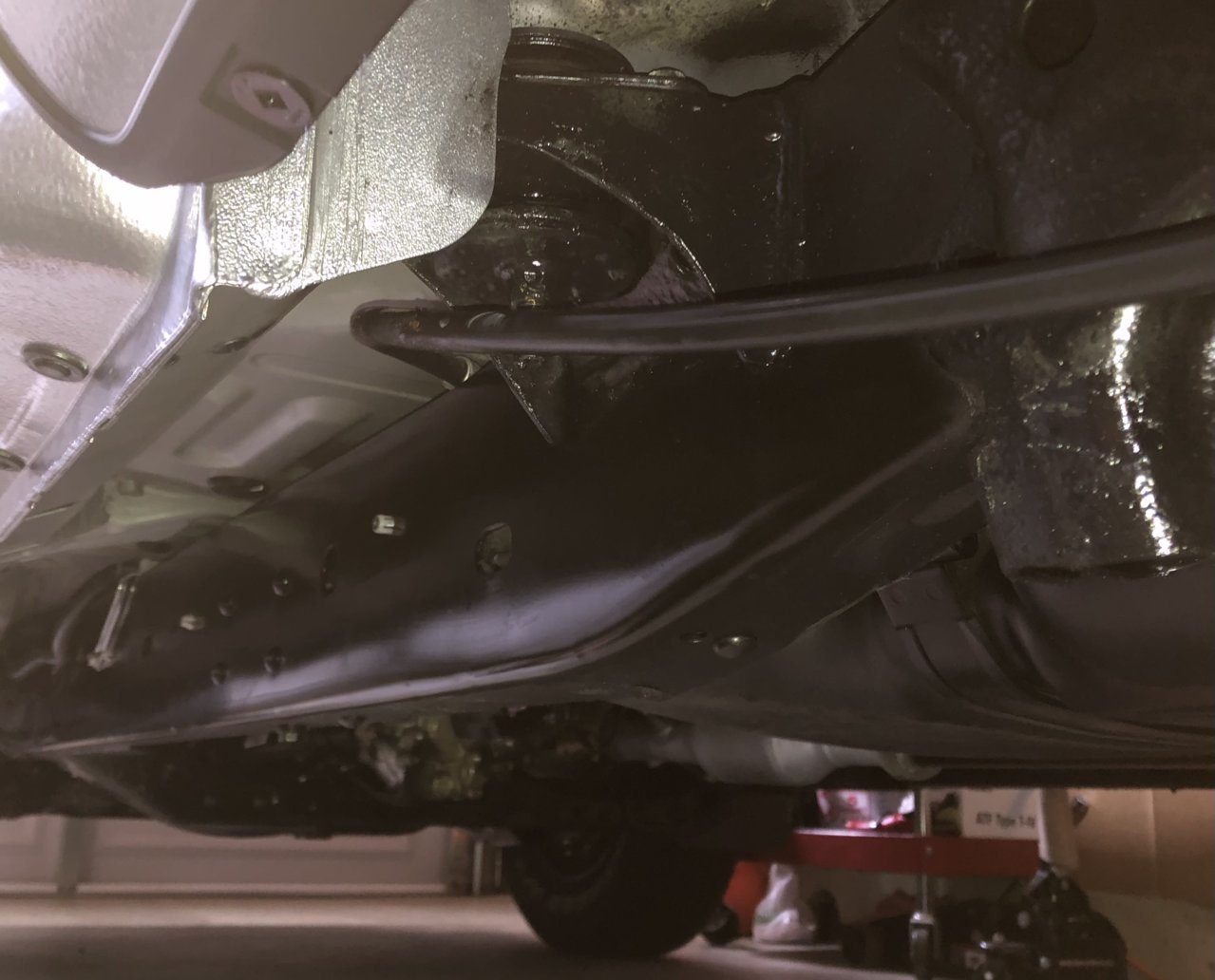

    I moved to Michigan in 2021 and Coated mine with woolwax after talking to these guys. The Michigan guys know what’s best and are helpful and knowledgeable about this state. Listen to them because they know what they are doing! I only have a little under 4000 miles on my truck and don’t drive it much in the snow but Kent county puts so much Brine down that the Residual kicks up on the dry days like fog on busy roads. You know we’re breathing that stuff? Just moved to the Lansing area last month, not sure how bad it is here. I’m ocd about detailing.. I leave the outer frame exposed adding multiple coats of a wax sealant and then the Adam’s under carriage spray on anything I didn’t want woolwaxed. I put sealer wax on rubber gloves and get under there and put it all over my exhaust as well after washing that too. I am insane. This was a 15 hour detail process last week.

    I used about 9 rattle cans.. pressure wash your undercarriage, put cardboard down and put your truck up on some wood blocks if it’s not lifted. Wear some crappy clothes, a bandanna and eye protection. Cover your exhaust and spray. Then wash your truck after.
