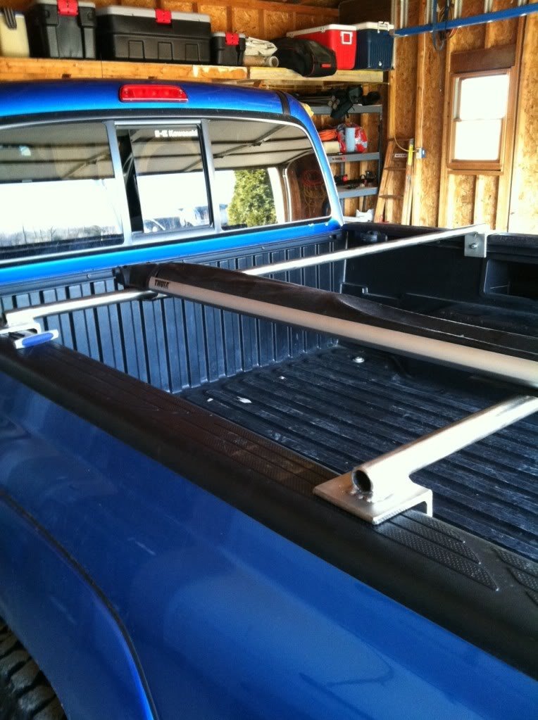

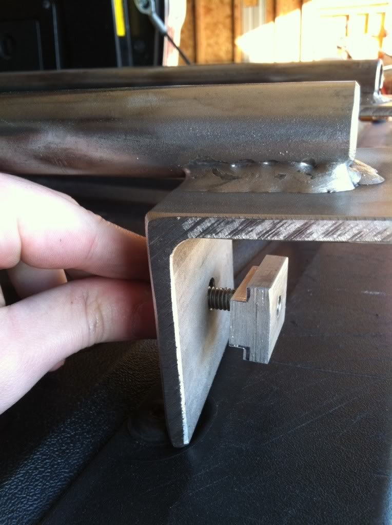

    Added my 304 SS revisions to the truck today. Along with new hardware set up.

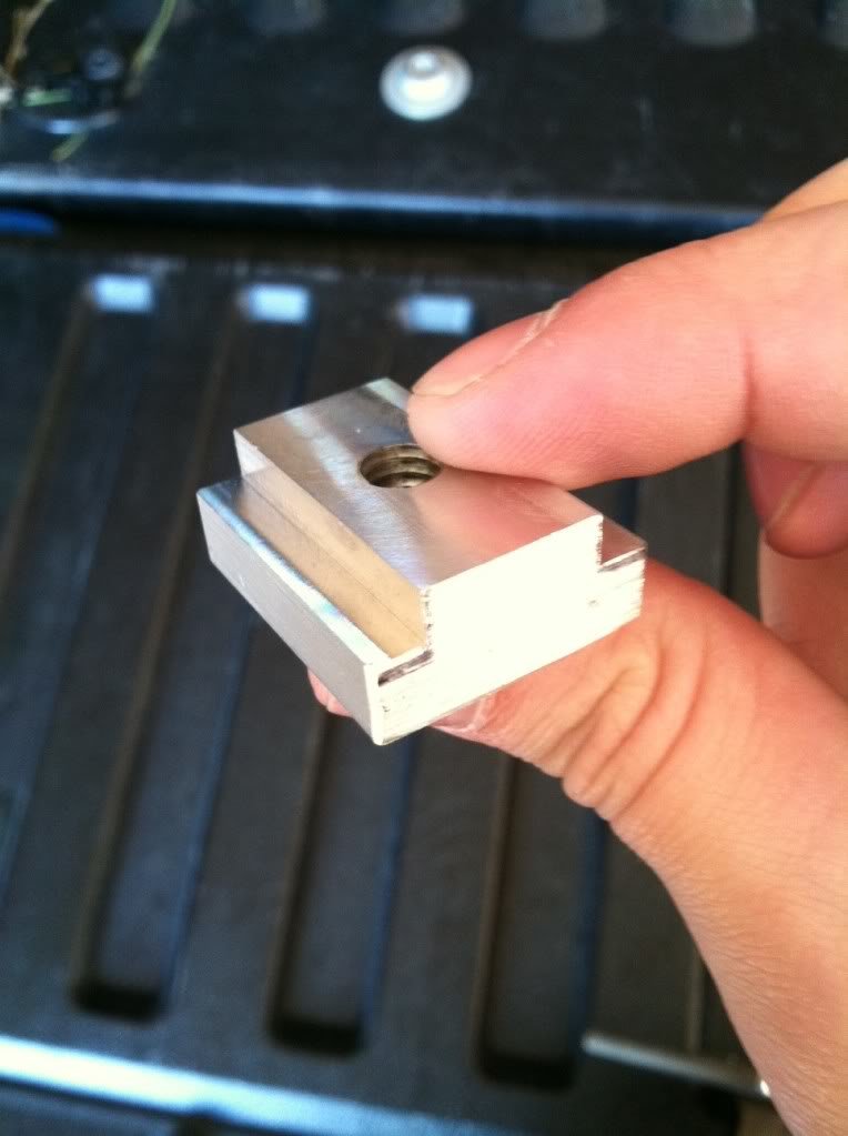

    Aluminum T-Slot Nuts
    Weld looks like shit I know! Hot gas was a little much for the sch40 pipe. Ended up filling undercut on most of it. :facepalm:

    ah I've seen farrr worse welds than that! looks good :)

    If any second gen guys want the set that I made out of mild steel I will make you a deal on them. They are good for at least 300lbs across both. I think factory Toyota bars were rated for 150ish across both. Not going to ship so will have to meet somewhere for sale.

    Nice, what you planning on toting around on that thing?

    Mountain bikes, maybe one of those baskets for camping gear and other small things.
