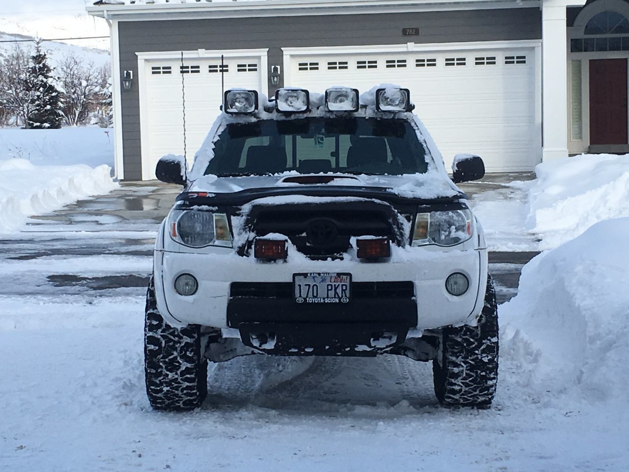

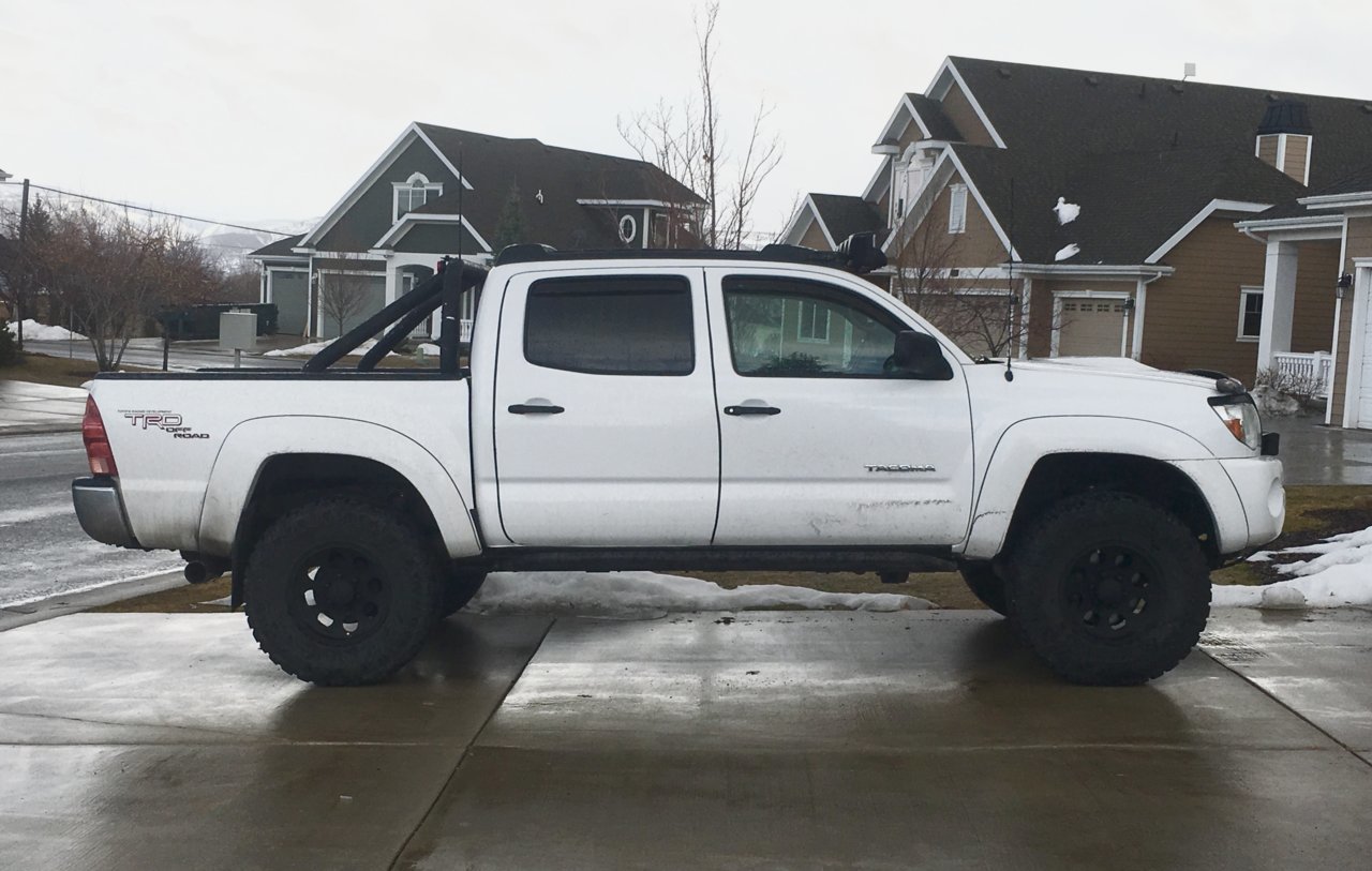

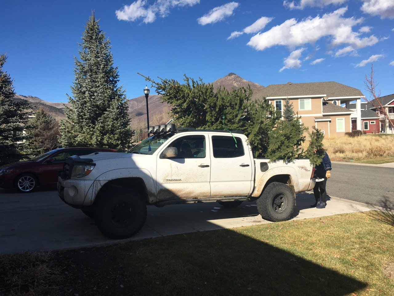

    I'm running a similar setup to you on 305's, however they are Fierce Attitude M/T tires.
    16x8 rim 4.5in backspace, no spacers.
    Just under 3in lift at maybe 2.8in with spc's as well.
    I had to chop a decent amount out of my cab mount and minimal cutting of my fenders. I don't rock crawl much so it doesn't flex a whole lot but I have put it through its paces with minimal rubbing. Every truck is slightly different though and alignment might affect if you rub or not.
    I personally went with 305's because they are a little wider and like you wanted proportional tires. For me I wanted a wide tire look.
    I do agree though that finding 285's are a lot easier but luckily I've never had any major issues in my time on the trails.
    And of course all tires are slightly different. Mine are about 32.8in tall and tread width at its widest parts is 11in.

    That looks good! i agree the wider tire looks better. Would you happen to have a side view shot as well? I also don't understand why this tire size has a lower max load and max psi?

    Agreed, since the tires are already 3500lbs+ I wouldn't worry about that at all.
    As a side note, I run my 305's at 29psi. Best on road pressure for me after doing the chalk test.
    TopKick[OP] likes this.
