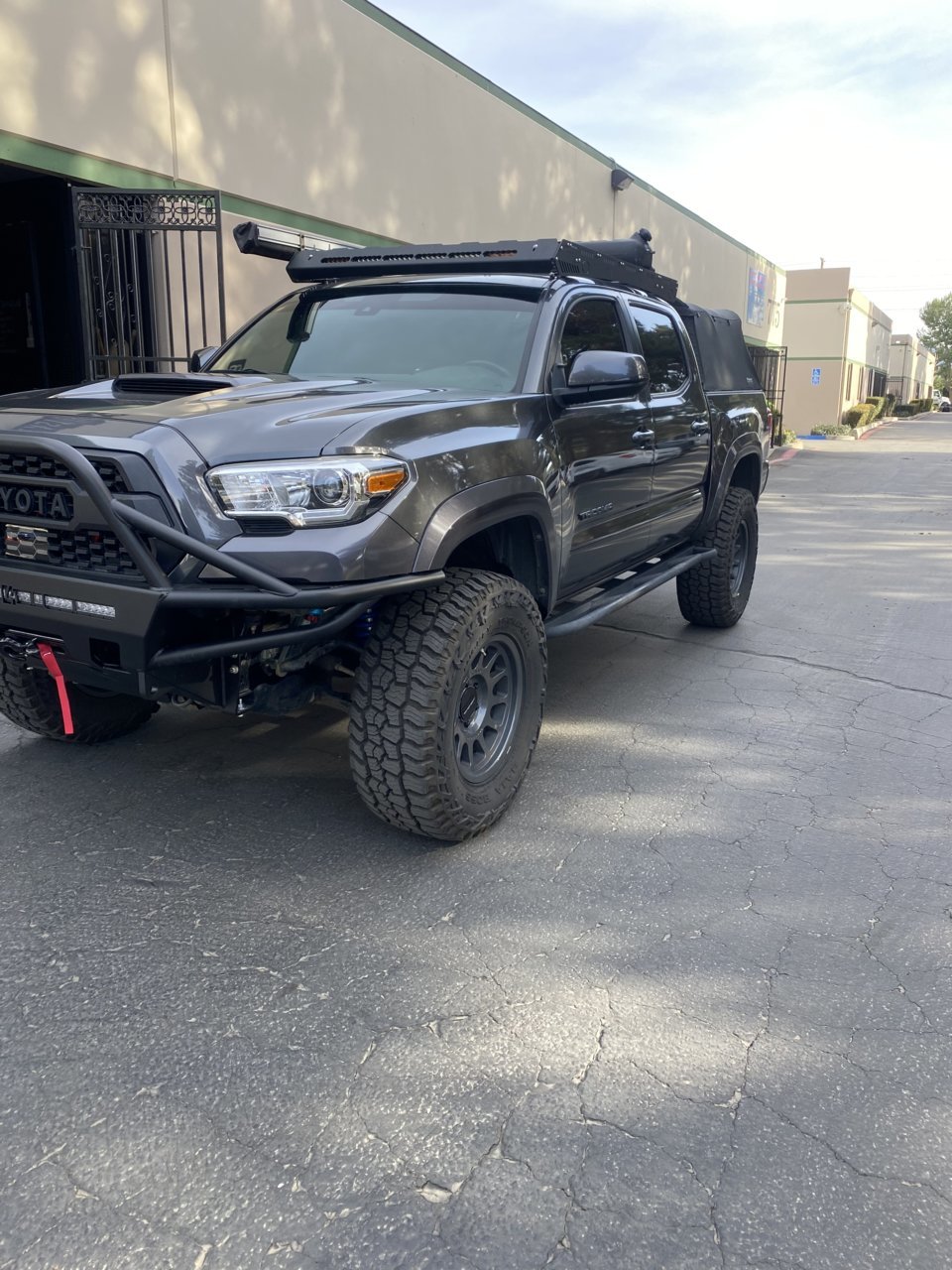

    Had these installed in September and love them. Went from KO2 275/70r17s. They're 295/70r17s on a 8" wide Aluminum flow formed FN Six shooter 0 offset. Have a CMC and pushed back firewall with a 2.6" lift on King shocks and Camburg UCAs. Rears are on Icon RXT Leafs option 3 on King ext travel rears.
    They weight in at 70lbs per tire and 90lbs with the rim. They're just as quiet as the KO2's in my opinion with WAY better handling in the rain. Maybe the increased weight has something to do with them but my KO2's always had issues with traction in the rain on roads even when new. They're definitely an aggressive AT.20220912_171041.jpg IMG_20221226_204233_677.jpg 20230127_142326_2.jpg

    That size won't rub unless you've messed up your suspension

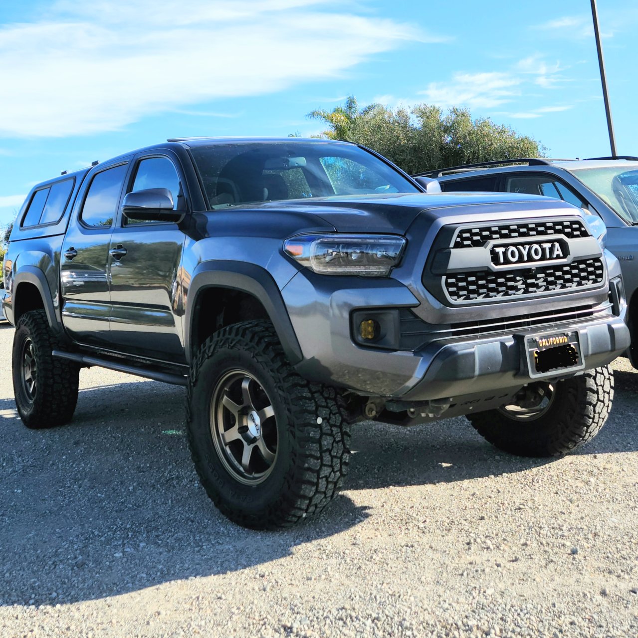

    Going on 2 months with mine. 295/70/17 on zero offset Method 703s. These things are an absolute weapon on the dirt and deep sand. Really love their road manners and lack of noise. Went from 265/75/16 Wildpeaks and was so shocked how much quieter they are. LXGG8513.jpg
    The C4 bumper gave me a lot of clearance but still need to CNC, hammer small section of pinch weld aswell as trim plastics...
