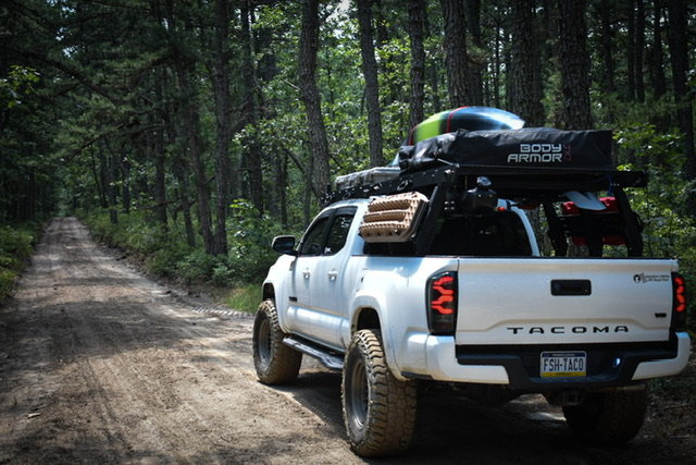

    I have about 10k on mine, air up and down, the road noise (obviously it’s different for everyone), is minimal, and they’re wearing very nice. Highly recommend them.

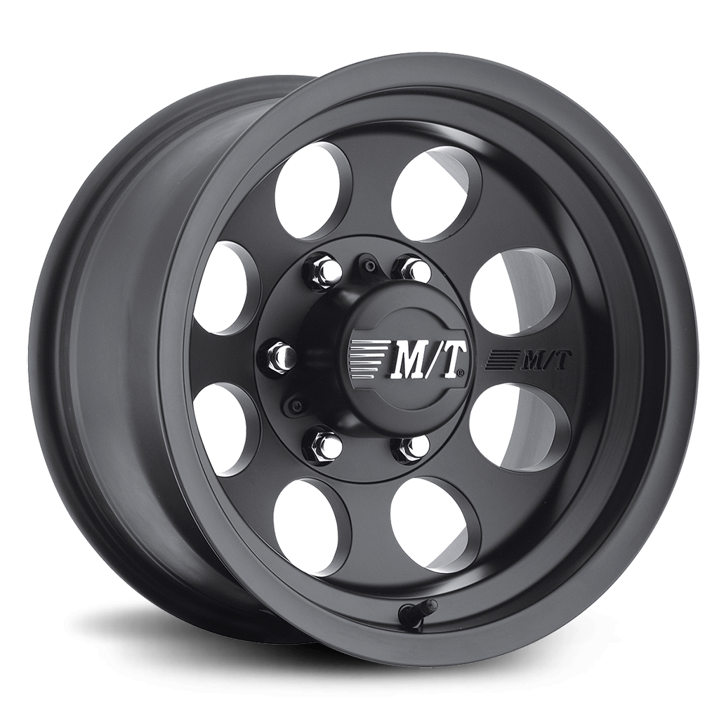

    Just ordered a set of 5 in 285/75/16. Also putting them on some nice new Mickey Thompson wheels. Wheels are back ordered a bit so the wait will suck, but I'm excited that I finally arrived at a decision and am going to have a proper 5 wheel rotation.

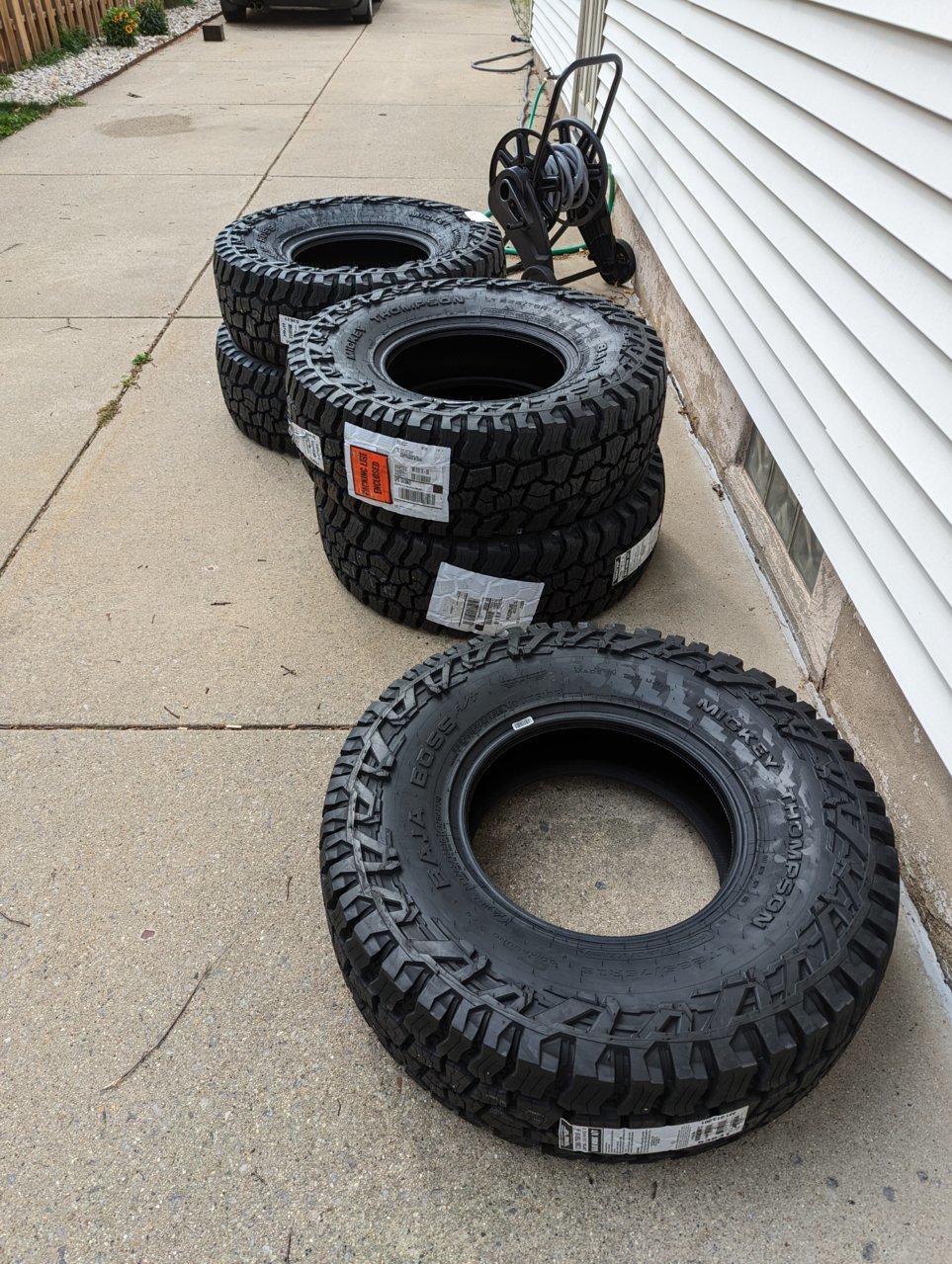

    Bunch of rubber sitting in the driveway this morning!
    Wheels arrive tomorrow. Giggety!

    what size?
  15. Sep 20, 2023 at 5:50 PM
    #395
    rubbersidedown
    rubbersidedown Well known voider of warranties
    Jun 22, 2022
    #399907
    1,749
    Dean
    WI
    2020 Tacoma TRD OR Long Boi Voodoo Blue
    285/75 R16 According to the Mickey Thompson site, they're 32.9".

    What wheels you go with?

    Are they Toyota specific? I ran a set of mickeys with the right hole pattern but not the right hub size and they were a pain since Toyota wheels are hub centric. I had to run hub rings to make up the difference and they were super hard to balance all the time. Shook no matter what. Switched to Toyota specific wheels and no more problems.

    Never heard of wheels being referred to as Toyota specific. The hub bore is 106.1 which matches up with any Tacoma I believe.
