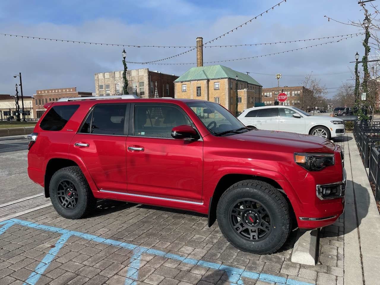

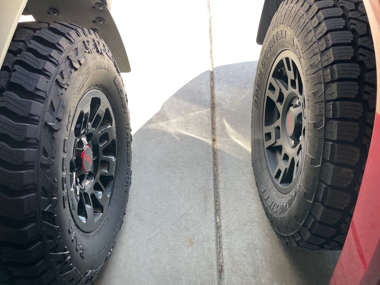

    I went with the 116Ts, which I think are still an attractive tire, and of course, lighter.
    (116Ts on left, on right are the Toyo Open Country's on my 4Runner.)

    1. I put both sets on end of last January. I didn't want the same tire on both, so the Toyos and Mickey's are what I settled on.
    2. They are both 3-peak rated, but I haven't had them in any slick conditions (ice/snow) yet. I'm moving further north next year where I'll live off of a dirt road, and I'll have A LOT MORE of snow, so I wanted 3-peak rated.
    3. Driving in rain for both is excellent. Note, the 4Runner is the Limited with full-time 4x4. The Tacoma in rain, great traction with Mickey's.
    4. The Toyos (265/70/17) are quiet, as I don't even hear them. i slightly hear the Mickey's (265/75/16).
    5. MPG: -1 for the Toyos from stock, -2 for the Mickey's. Mickey's do look more aggressive, of course.
    6. During the next week, I need to rotate both sets, and I'm interested to measure wear over time.

    Yes, I went with the lighter tires for both, not the E rated, for mpg reasons.
    Toyos are the AT3s, 115T AB
    Mickeys are 116T AB
    The Mickey's do look more aggressive as they have more tread depth. Yes, I'd buy them again, assuming wear is acceptable at 20k. I look forward to trying them both out at my next house out in the woods. :)

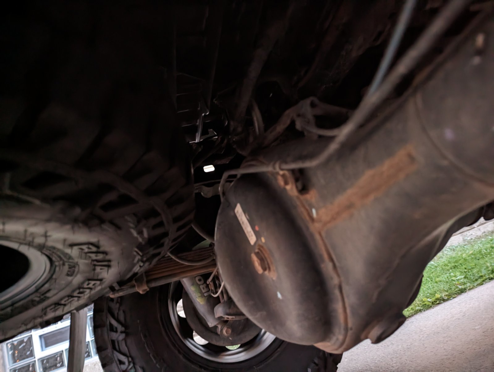

    Nice! It looks like it may be rubbing the diff a tiny bit. You can gain a little extra room by lowering the spare a little and pull it towards the hitch as you raise it back up

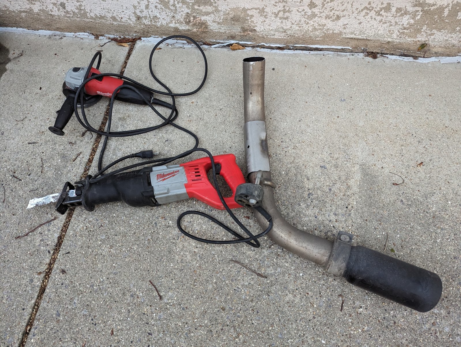

    Nope, definitely clears the diff. The dust/dirt rubbed off of the diff was from my initial checking to see how much clearance I needed before chopping the exhaust and moving the hoist.

    No, I have a DCLB. Mine is an OR and it looks like you have a Sport. I think the diff is bigger on the OR. Not sure if there are any other differences.

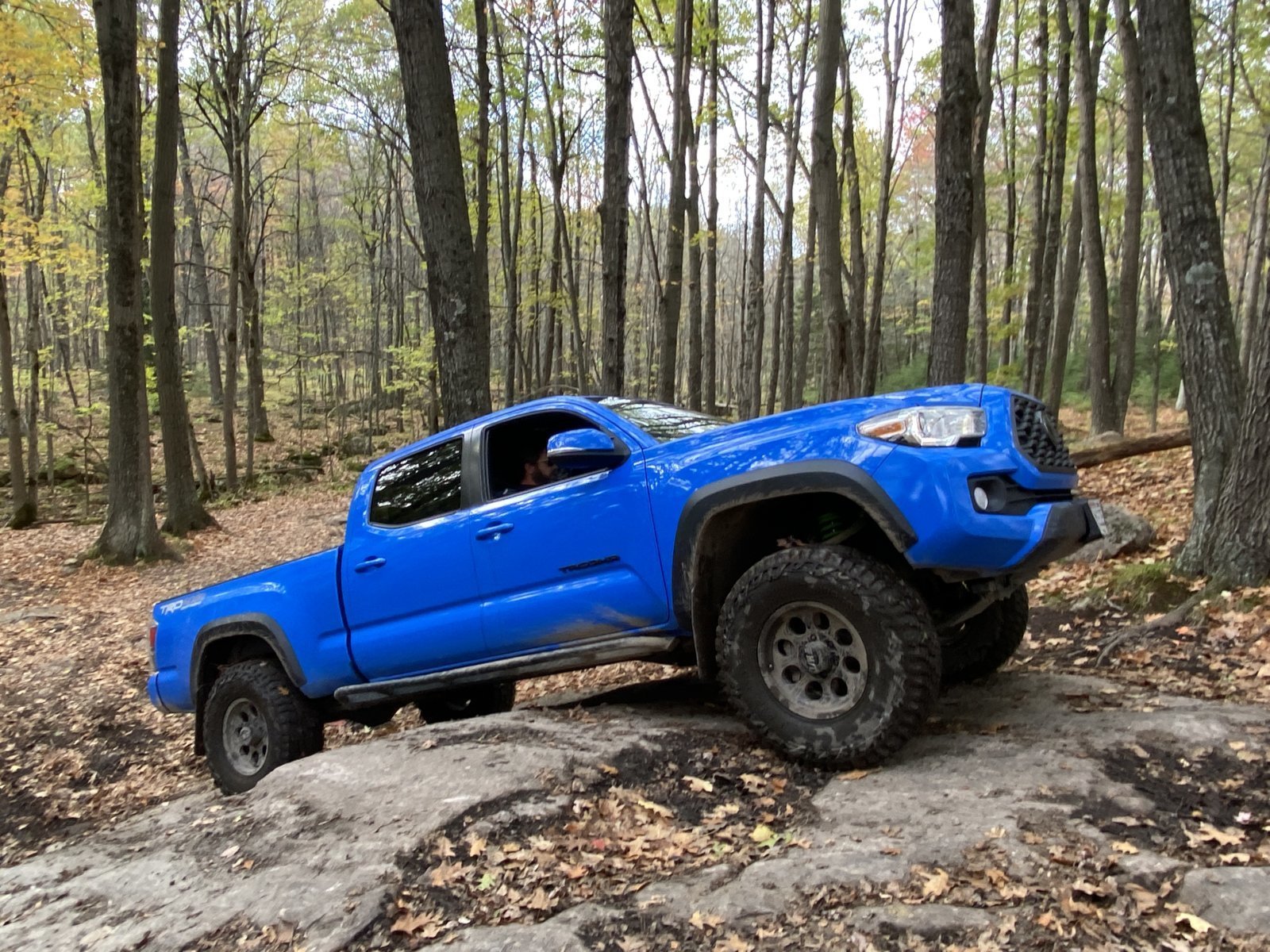

    The Mickeys did not disappoint last weekend.
