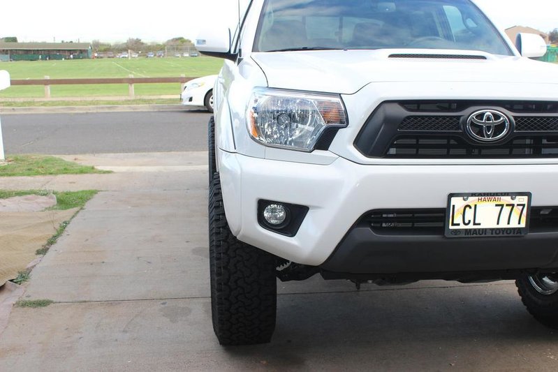

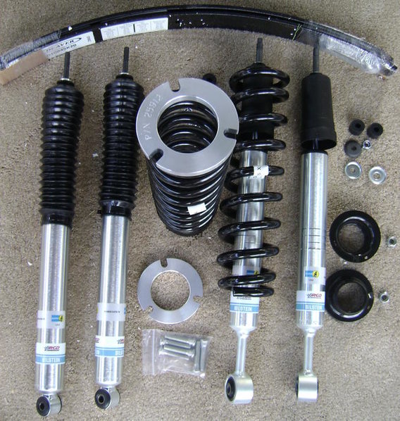

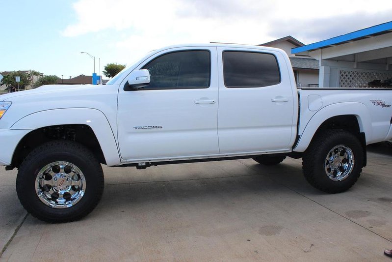

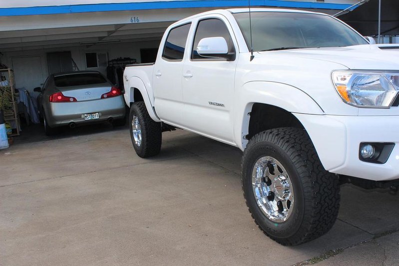

    OME 885 Coil lift with 1/2 top plate spacer & 6 studs - 3" lift
    Bilstein 5100 series shocks & adjustable front shock (0-2.5" height)
    2" Add A Leaf (2WD or 4x4)
    17x9 chrome moto metal wheels
    -12 Offset (no wheel spacer needed)
    4.53 bs
    285/70r17 BFGoodrich All Terrain
    just removed the mudflap

    Those look sweet! May get a set for my '19 SR. :)
