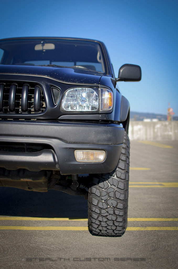

    Just barely past the fender. My tires are pretty much even with the outside edge of the black flares, so figure yours will be 1/2" further out.
    For reference that picture is with 4.5" of backspacing...
    Sorry, couldn't find a 1st gen w/ 4" of BS.
    Read through this thread, Bobert is running 16" w/ 4" of BS on 285s. Just scroll down till you see the pictures with the black wheels.
    http://www.ttora.com/forum/showthread.php?t=126500
    Glad you finally got it all figured out man.
