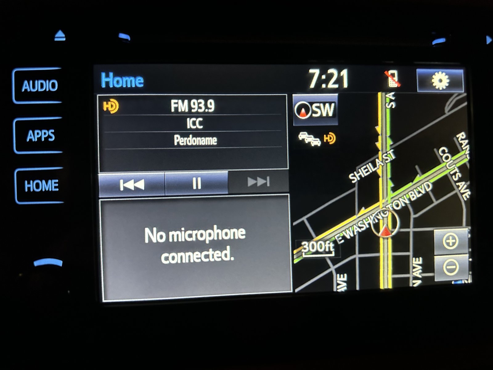

    Hello everyone I need help just bought this 2017 Tacoma trd but it came with some issues I got cheap knowing the issues
    1-Microphone is not connected message I can not pair my iPhone

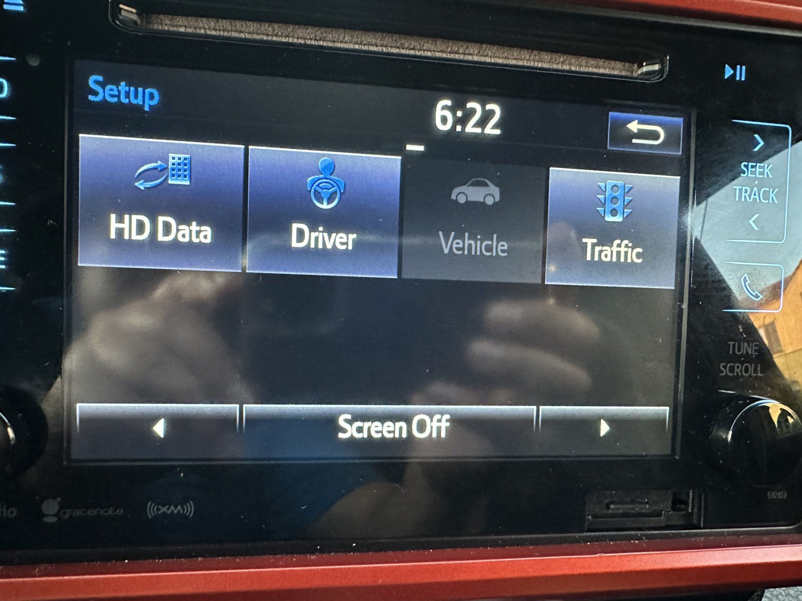

    3-Driver settings is grayed
    4-Vehicle settings is grayed

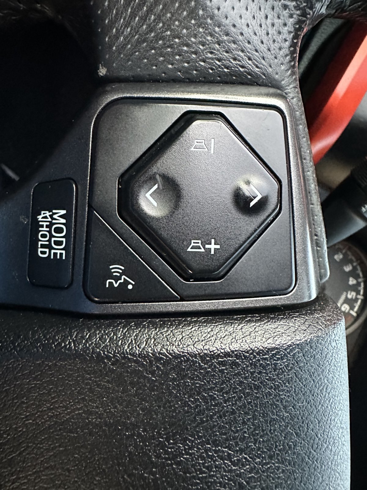

    5-volume control in the steering wheel don’t work

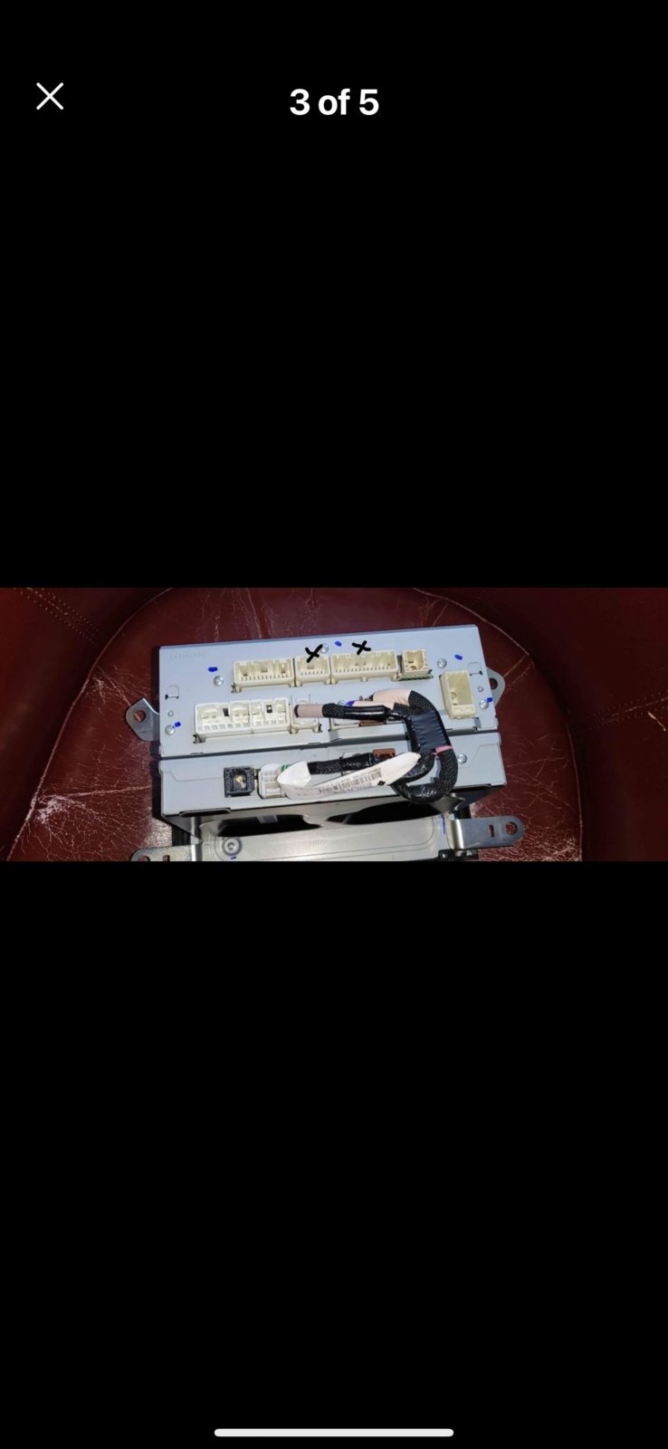

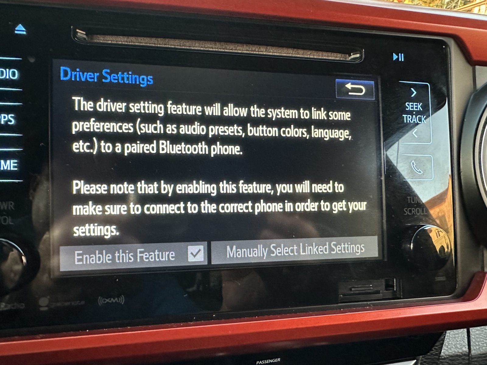

    So I took it to 2 different stereo places and they told me most likely is the estéreo unit then I found a couple used same model number I connected everything but still have the same problem I was able to turn on drivers settings that’s it luckily the person let me try the stereo before I buy it. If you see last picture the 2 top middle slots mark with an X didn’t had anything connected I when I remove the head unit to I connect the other one so I wonder if anything goes there and if that might be the problem I didn’t find any other connections inside.

    In mine when I switched out the head unit, I remember seeing an orange plug in the factory wiring harness labeled microphone. It might have came unplugged behind the radio.

    The volume control in my steering wheel
    The drivers settings
    And vehicle settings

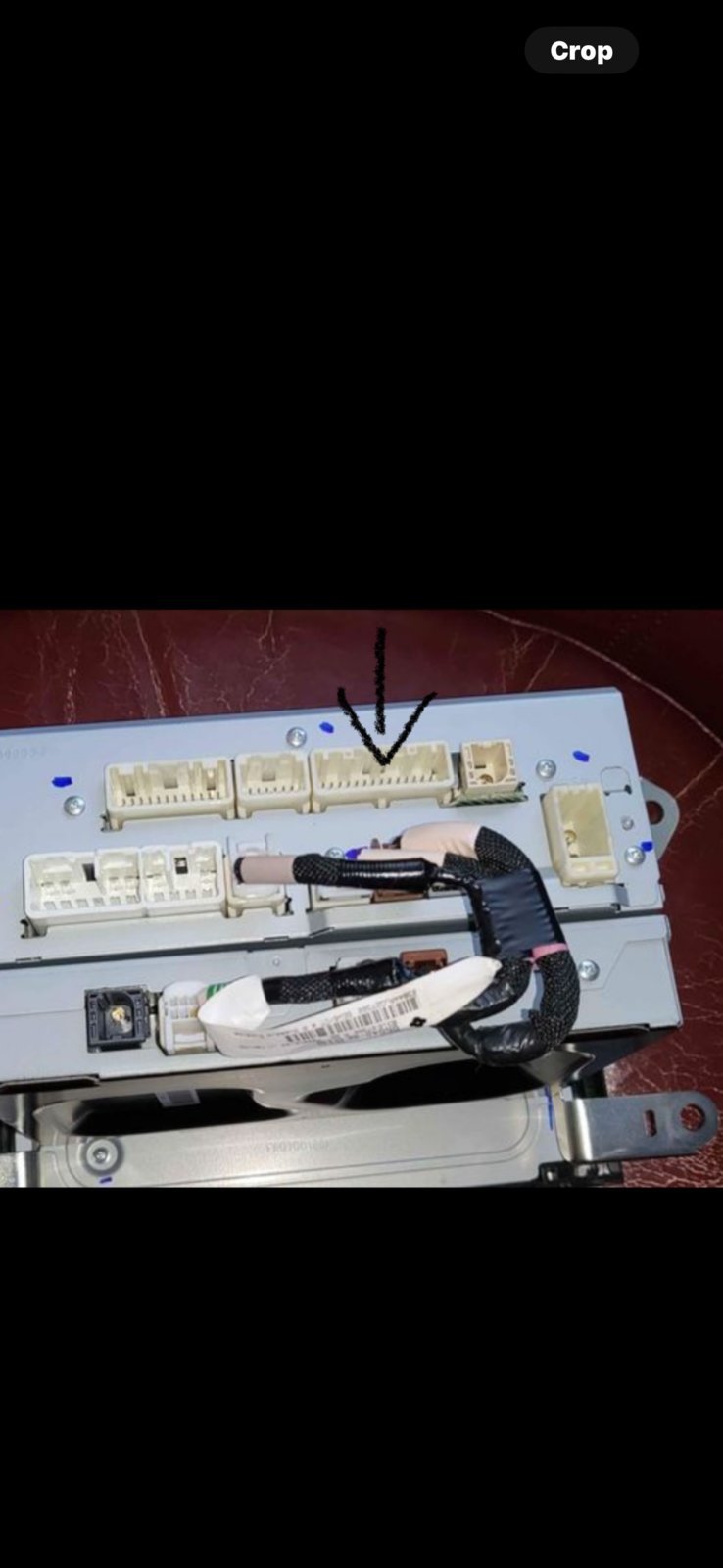

    Everything work now it took me like 45 min to remove half of the dashboard the was a plug missing that goes connect it to the 3rd connection from top left to right that controls all of them see picture that solve all the problems thanks every for the advice.
