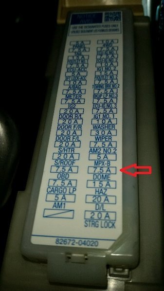

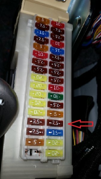

    So to do the add a circuit, you will first (duh, lol) need to purchase the correct add-a-circuit jumper that will work with your truck. I will research this for you later on today. I have enclosed some pics below that i have found (on TacomaWorld) to be the 2016 in-dash fuse blocks under the drivers side
    Yer gonna want to ultimately remove one of the stock fuses, add your add a circuit, and then install two fuses in the add a circuit holes. And voila. You have a fused circuit. For a circuit that will work when they key is turned on only, remove any of the fuses labeled Ignition (ign1, ign 2)
    Please ignore the arrows in the picture, as it was posted online for something else

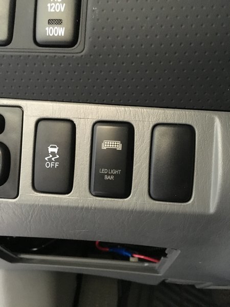

    they have a backlight and an accesory on light also (when unit is on). In my very first picture, the two switches on the left are actually ch4x4 and the right one (broken one, lol) is a Mictuning. They are pretty much the same. Even the wiring configuration is the same
