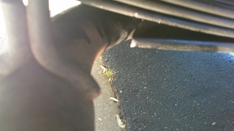

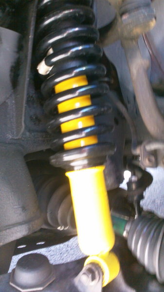

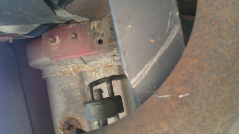

    The first thing I tackled was the 20 year old suspension. I went with the OME heavy duty shocks and springs with the Dakkar heavy duty leaf springs for the rear with upgraded bushings. All from ARB. They suggested removing a few of the leafs from the stack. Due to my camper remaining on my taco I choose to leave them all in. I would suggest to ANY one that it is waaaay worth getting the front coil overs built up and ready for install. Also the rear leafs take a lot of compression to get center pin in place. I had to drive over a curb to get it to drop in. Pretty straight forward however no instructions or pics for this mod. No rear brake valve adjustment needed.
    Stock rear leafs and shock on top vs. new OME and Dakkar Leaf below.

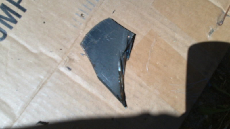

    Trim line on right rear leaf spring so exhaust will not get pinched.
    How much was needed to be trimmed.
    Leaf spring now clears exhaust when truck is unloaded.

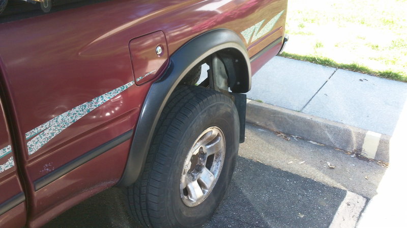

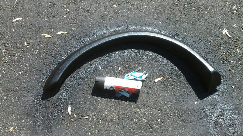

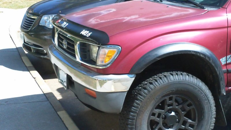

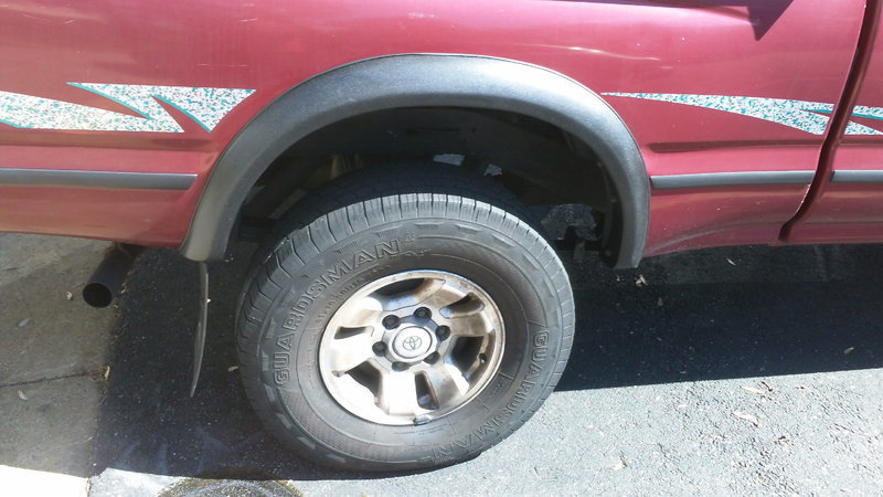

    Next up was easy. Put on Bushwacker 2 n 1/2 fender flares like what came on later model tacos. Not too crazy!! Primed and sprayed them with spray on truck bed liner from Wally mart.

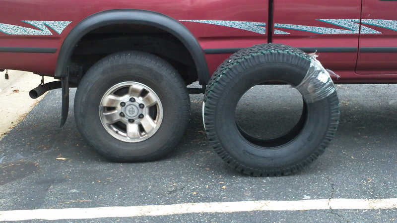

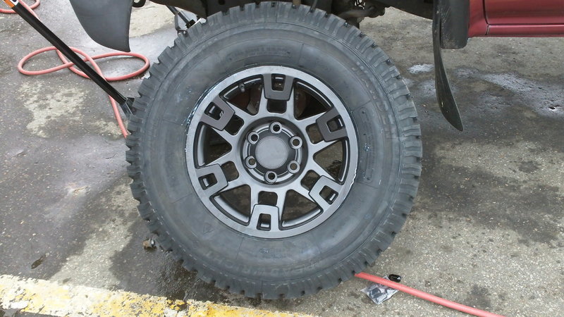

    Now for the next trick. New tires and rims..... I got a set of FJ 17' SEMA rims. Lots of home work on the tires but I could not be happier with what I found and at a great price. Treadwright 265/75/17 ATs. They are bead to bead remolds and awesome. I might attempt the mud crawlers next time. A more aggressive tread!!

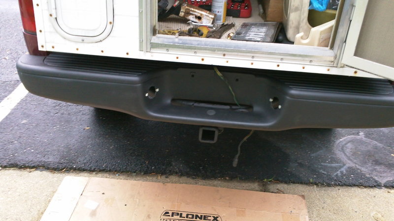

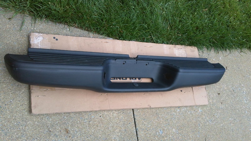

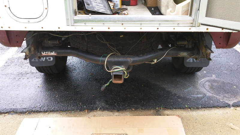

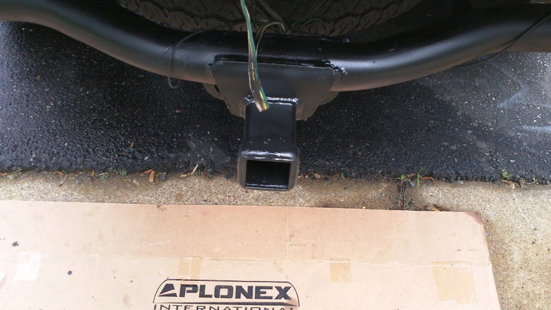

    Another straight forward easy job was the rear bumper. I just went in with another stock OEM bumper black powder coat however. Getting rid of the chrome. Again prepped the under and back side with spray on undercoat and outside with spray on bed liner. Replaced plate lights as well.

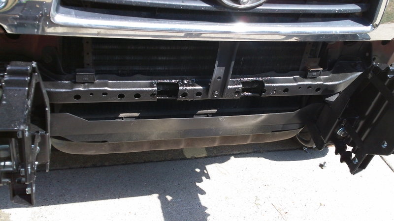

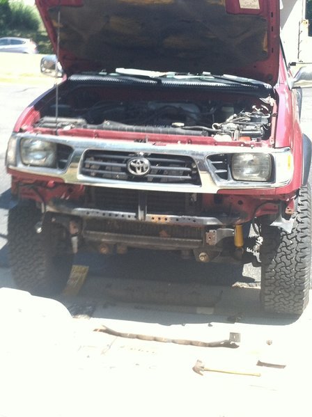

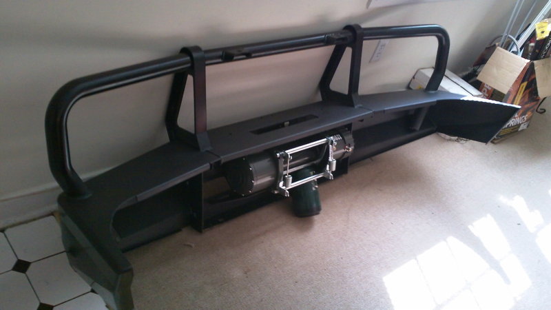

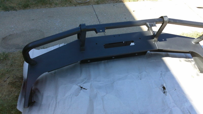

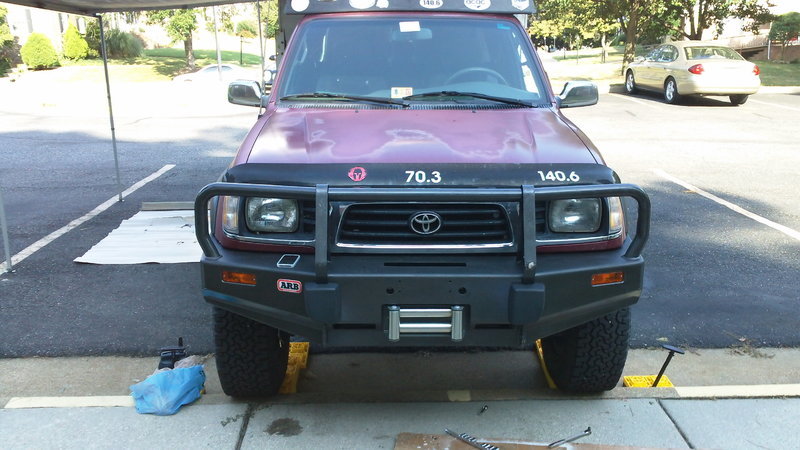

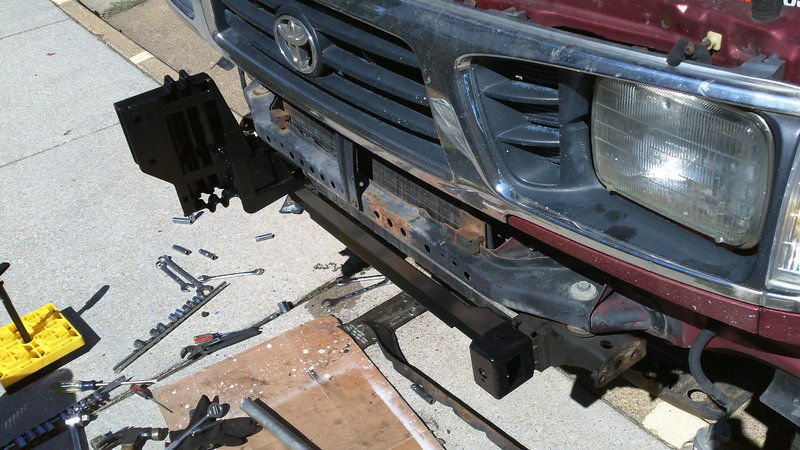

    With the rear bumper done it was time to move to the front bumper. I did a lot of looking and figured for the buck the ARB deluxe bull bar was best for me. White tail dear and a adult Roo are about the same in weight. I'm glad I've not met with either yet at 60+ mph but there have been plenty seen on the road side over the 247K I have put on this taco in the last 20 years. This was another straight forward install pretty much considering all the threads I read on it and issues folks had. The one issue I had came from an accident many years ago when I removed a Ford probe off the road. The right rail still has a twist to it but was workable.
    Before
    Ready for painting wench just dry fitted.
    Old Bumper removed.
    Top deck painted. Inside coated with undercoating.
    Left frame extension, right bracket on. Did not have to cut any thing off the frame had to use the original bolts from stock cross member.
    Dry fitted with out wench installed.
    These two cut out are for the wench cable guide springs as I went with a 12,000 lbs. Badland wench and not a Waren 9000 lbs.

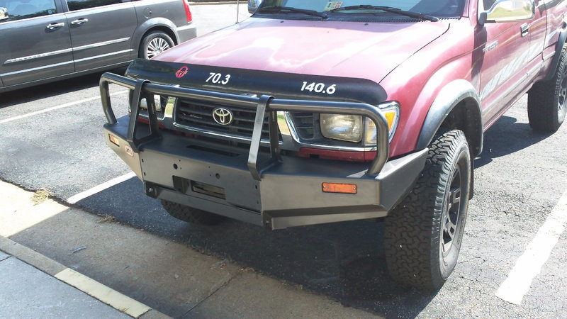

    All bolted in just need to finish wiring turn signals.
    After....... BAMF Adornments are next to come.

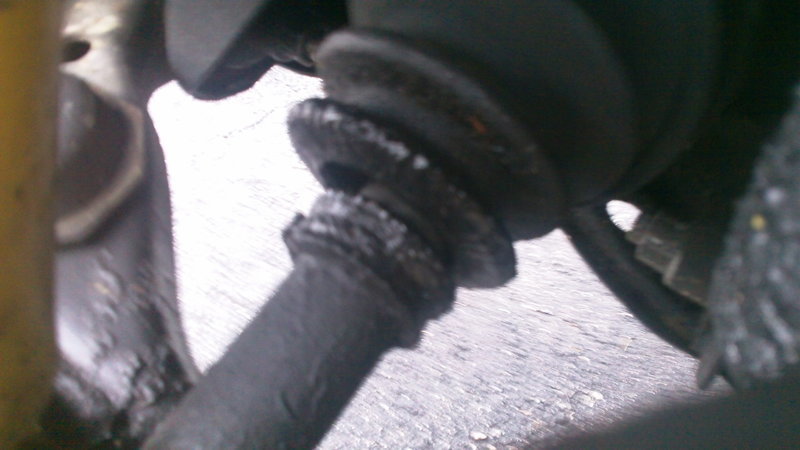

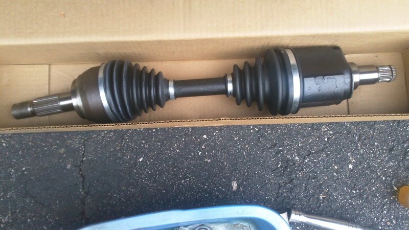

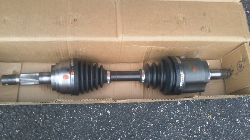

    So I have had to now replace the two front axels. While doing so I have swapped both front and rear differential fluid as well as transmission fluid for Royal Purple 75W-90 The transfer case is being a bit of an issue and I will post that later. I'm headed to the Overland Expo and have run out of time for now. This will be a good shake down run on a few of my mods.

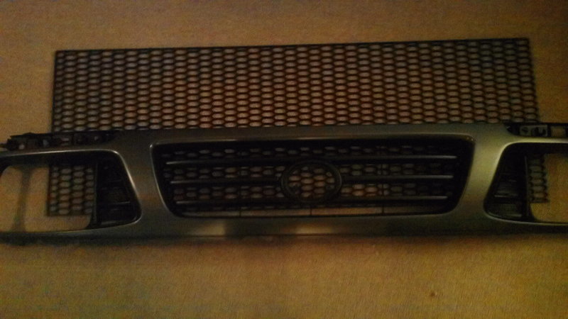

    Custome grill materials are all in.

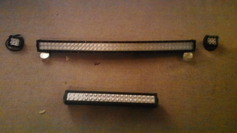

    Main LED lights are in. Got a few more to get then I will run all the wiring at once. Need to figure out my switch box too.

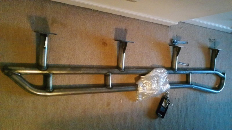

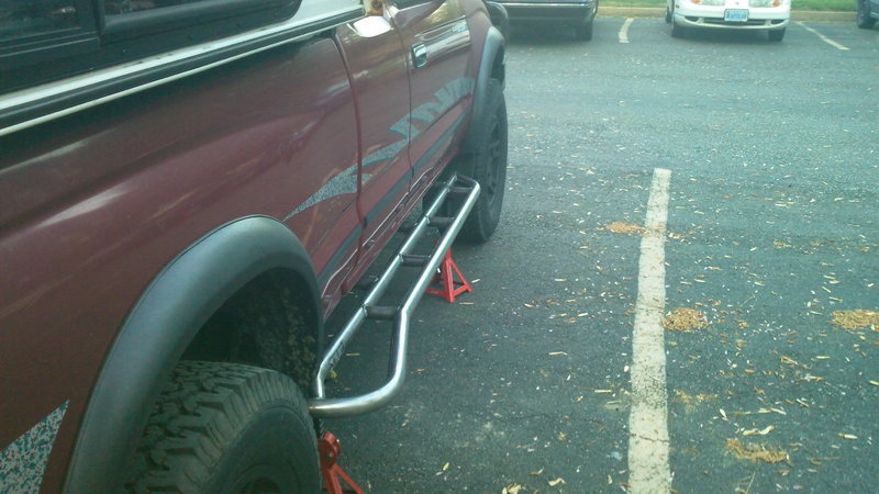

    Well just dropped the Benjamin's on these sliders. The only descent bolt on's I could find of my Taco. I will update when the arrive.

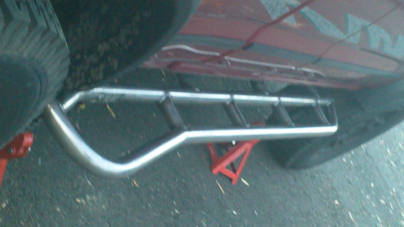

    Ok they have arrived and now I need to find me a welder.
