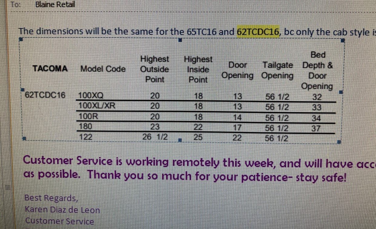

    This is direct from Leer that I acquired for the specs when I purchased a Leer 180 for my 2021.
    I don't know if these are identical for the 2nd Gen but I'd guess they are or are close.
    You could measure from the bed rails up for the highest outside dimension and get an idea on you truck. 20" for cab height and 23" for the mid-height 180.. but notice the inside dimension varies.

    In addition to contacting a few local dealers I actually took the time to send an e-mail directly to Leer. All the dealers could tell me is "about 4" above the cab" and Leer, as of yet has not responded to my e-mail.
    Can someone tell me, would I be safe to add another 5" to allow for the Thule roof rack?
