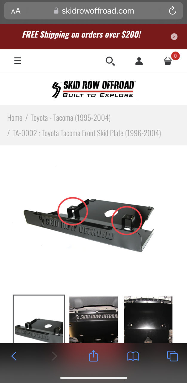

    I like my skid row plate- has added support/extra mounting points. 0233CA8D-4DB6-45DB-8DE8-00CF9921AF78.jpg
    Nessal likes this.

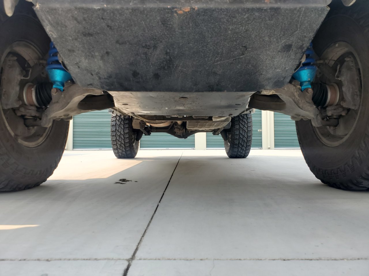

    One thing you won’t regret is buying a welder and teaching yourself to use it if you have the means. I built my front and rear bumpers as well as my transmission skid and added support to my transfer case skid and welded on my sliders. Saved me a lot of money.
