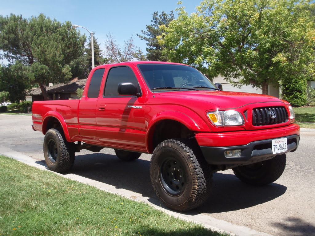

    Hey! First post on here (kinda nervous lol) but I always checkout this site whenever I have new projects in mind but I think its about time I made an account and joined the crew :cool:
    So I have been contemplating putting a solid mid travel lift on my 2003 Prerunner. I somewhat know where to start but at the same time its all new to me I have read ALOT of forums because I originally wanted to start with a LT kit but I started seeing 5 or 6 grand being thrown around :eek: and realized I cant afford that on a college student budget haha idk where to start so lets start with this...
    My budget is roughly $2000-2500 but can be stretched to possibly 3k if its worth it (ill just eat top ramen all school year:() but I want to do this RIGHT from the get go, not just stuff to get me by until I want the better stuff. I may not be able to afford everything I want but that's why I also have questions for down the road.
    I guess lets start with the basic. I was looking at buying UCA, coilovers w/ reservoir, smooth-body shocks for the rear. That would be considered a mid travel lift correct? do I need more on the rear end? I really want to get good parts as far as performance goes I don't know if I should/can beef up the front with really good stuff drive it (without doing harm) then save money and come back to the rear. obviously there is ALOT going on please help :notsure:
