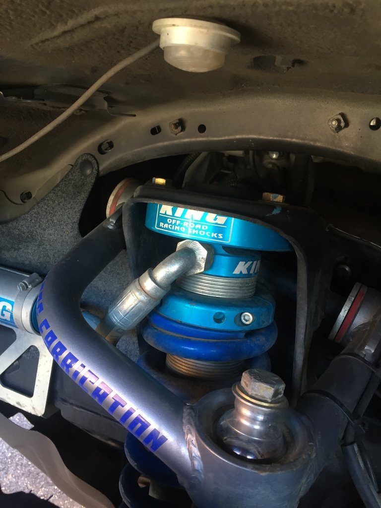

    how much lift could I crank them up to safely? 2621e1b53471cf434ecc76c9fc732227_5c4a3a091da17e621373f3f83370d209428ce633.jpg

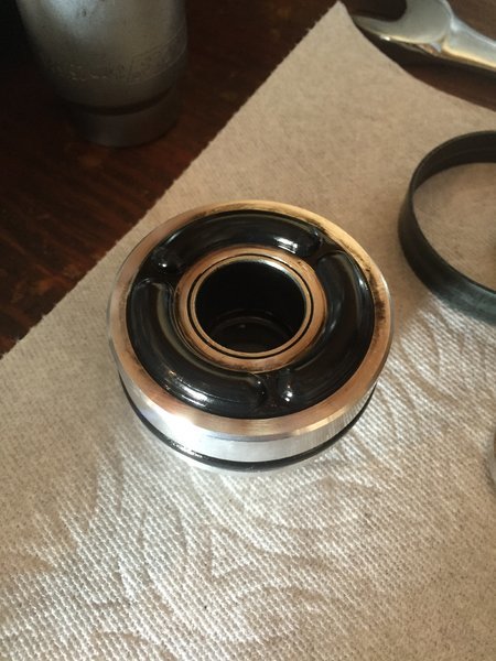

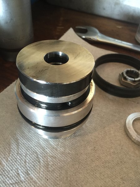

    From what I have seen in the mx/ atv world, is this style, and I have never seen any issues with bikes as far as the top out bumper breaking, even on some pretty old and beat up stuff. From your other pic it looks as if the top out bumper is free floating and not built into the seal head like in this side. That's why I think it cracked. Not that running straps is a bad idea, it's on my list of eventual mods, but if that other side was free floating on the shaft, that's why it failed. Why it's free floating and a different set up that normal, shock isn't in front of me so I couldn't tell you, other than it seems wrong to me. Never had a truck shock apart myself, other than my 5100's that disintegrated, and hopefully won't be rebuilding mine until sometime next year, but having done well over 100 mx/ atv/ utv shocks in my career as a bike mechanic, it don't look right to me.

    Sorry but this is a tricky answer. Ive stated what King told me but I don't think im anywhere close to having an issue with 3/4" thread showing on my driver side and 1/2" thread showing on my passenger side.

    So King recommends 3/4" thread showing?

    Yes sir, but there is a lot of argument here and for good reason.
    I was talking with @ckeene9 and he measured his by the coil itself.
    For the sake of argument take Kings 14" coil and that method, I should technically be at 13.25" if I compress the 3/4" that King suggests. Measuring by threads is difficult because for those that have swapped coils know that its going to take a few cranks to get that coil snug and start seeing height change. So does King take those initial turns into account?
