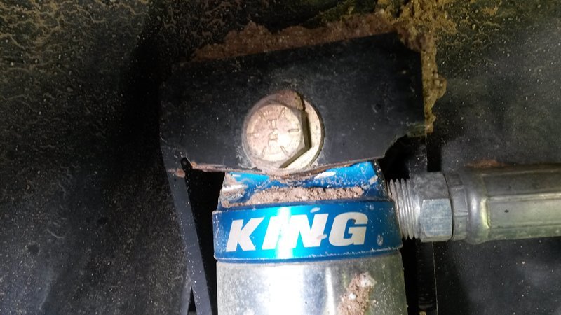

    Sorry it's taking so long to reply, I was underway and the updated wedsite won't load on gov computers. As for your question, I had the brackets unwelded, which was my only mistake. The only issue with the the 2.5, was part of the upper mount rubbed on the shock body, just grind the points flat.

    So you're saying I won't have to un weld the mounts? And if you could possibly upload a photo from where you had to grind it down ( i'm a very visual person) it would be greatly appreciated thanks again man!

    I don't know about unwelding the mounts. I will take a pic tomorrow and upload it.

    Here is the pic. The front plate had what looked like fangs that was touching the shock body.
