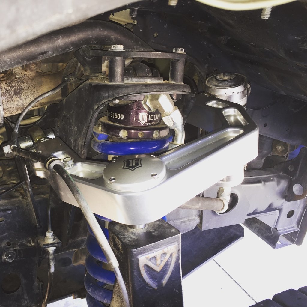

    No preload here. Just spindle lift and 14/700 springs
