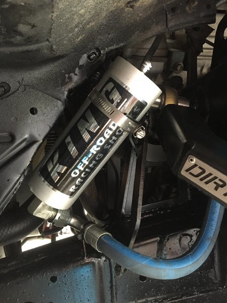

    04 SR5 4Runner
    King/Dirt King

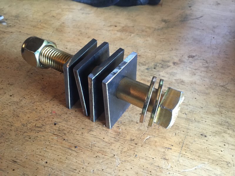

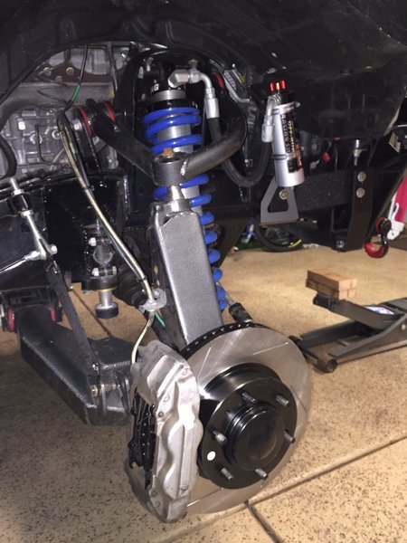

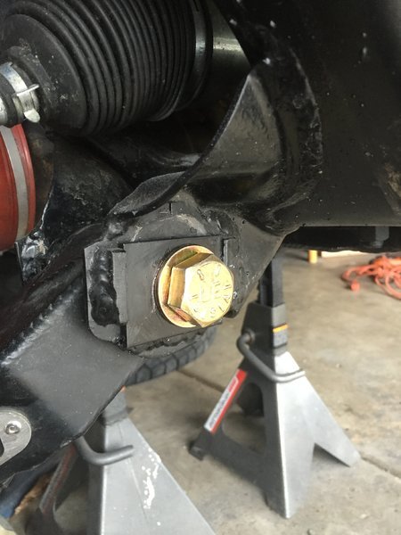

    Here is my setup that I finished dialing in this weekend, healthy dose of red Loctite on everything: Dirt King heimed uppers with solid mounted lowers, DK bucket gussets, TC tab and spindle gussets, Kings, StopTech lines, Kartek straps and Superbumps.
    [​IMG] [​IMG] [​IMG]

    Yes
    Why aren't you using the King resi mounts ? I'd be worried about that resi vibrating loose...unless of course it has red loctite on it :rimshot:

    They don't fit with the bucket gussets. I welded a resi mount to the gusset, and zip tied at the bottom. Not going anywhere. And yes, slathered in red.

    Ah gotcha, I had the same problem but I thought the new style ones would work w/ gussets. I had the old style King resi mounts that held the resi horizontal and mine didn't work either so I cut them up, modified them, welded them back together in a new configuration and rattle canned em'...f-n bitch to get the bolts back in them with the frame straps for my bumper too.

    Mine are the old mounts, and the 4R hoses have an extra 90 in them, so this ended up being the easiest way to get them on.

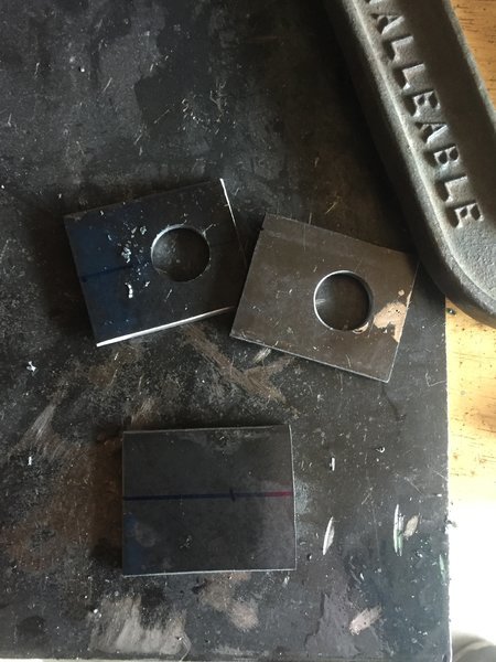

    two questions, what size strap is that? and did you buy the bolt and plates to fix mount the lowers as a kit? or make the plates yourself?

    8" Karteks, and I used a pair of RuffStuff shock tabs and 1/2" bolts
