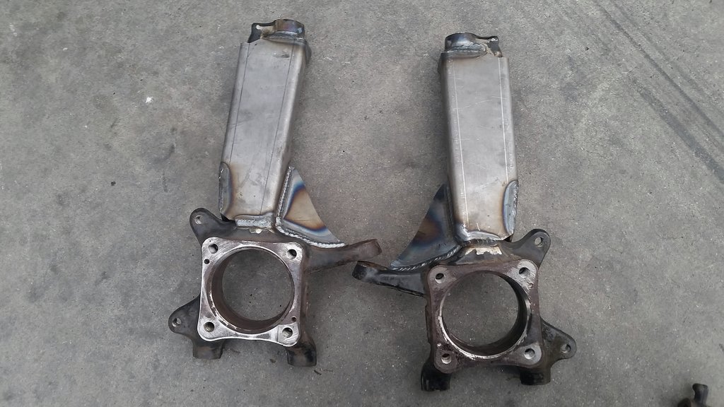

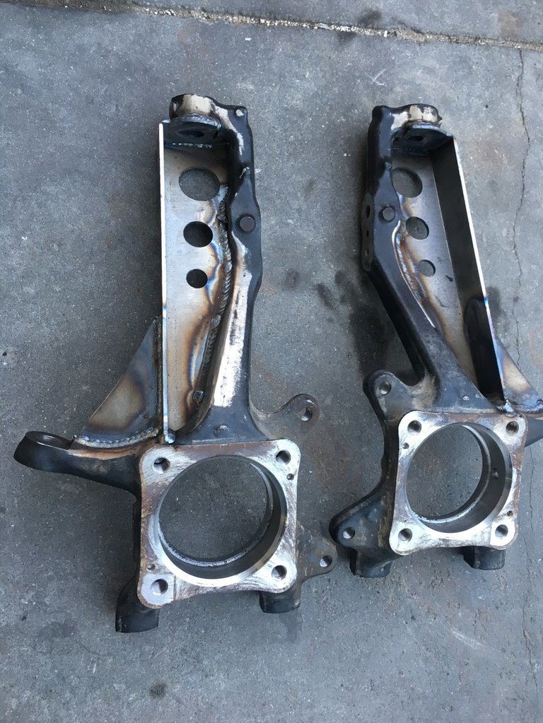

    Go ahead and order your spindles now before Jason sells out, plus if you have them early you can get them powder coated to match your new suspension parts... Because matcha matchy = +5hpimage.jpg

    Even if they don't match, gusseted spindles add +20 hp, so you're good either way!

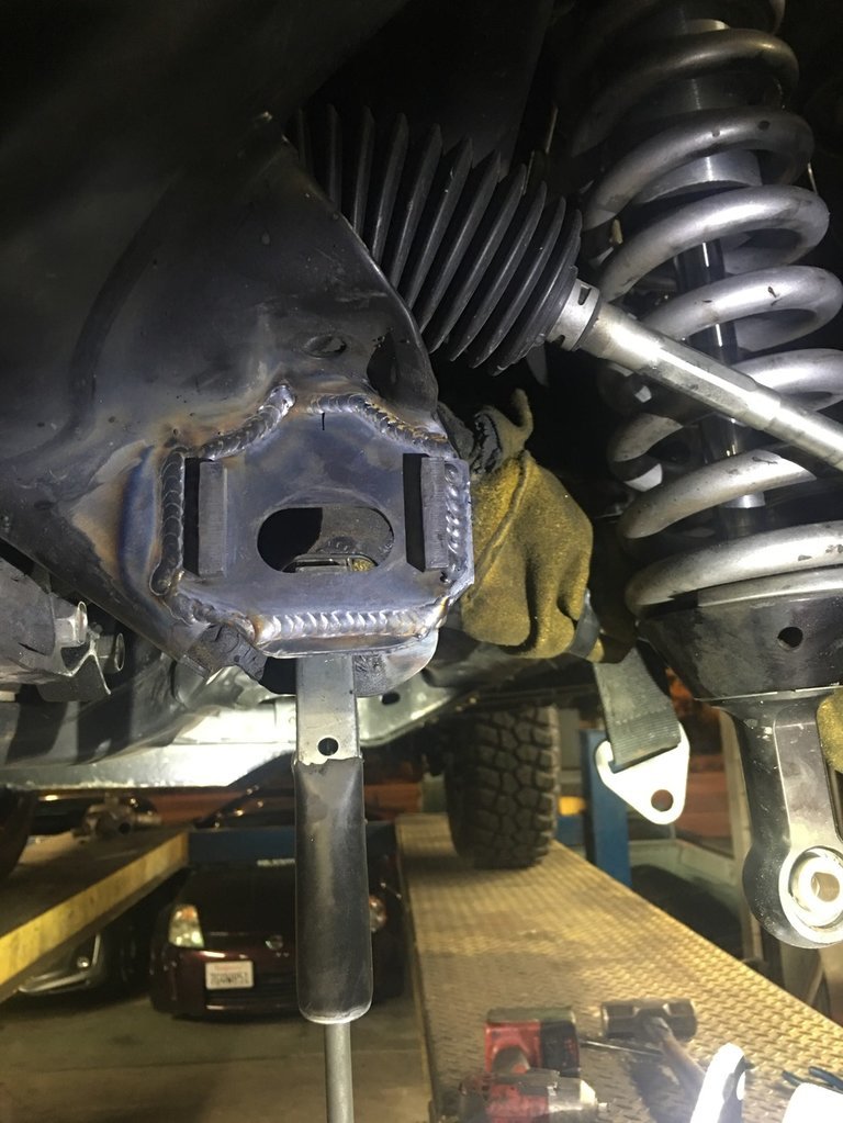

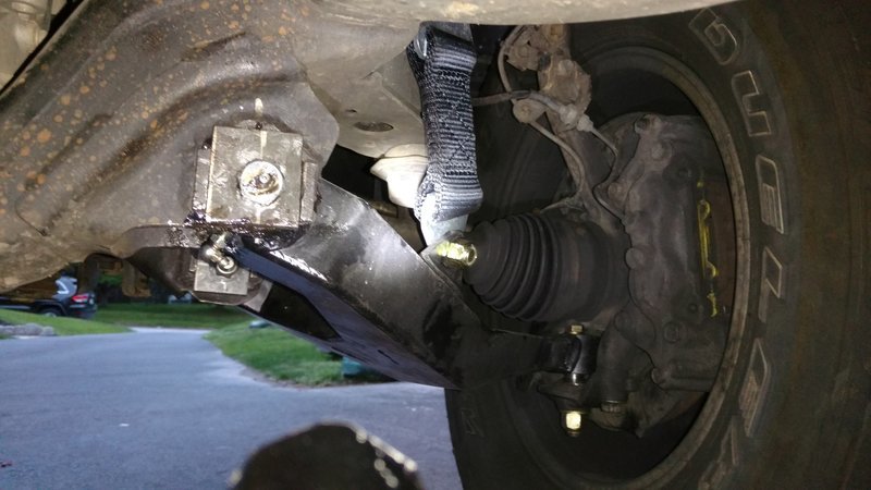

    anyone know where I can find a write-up on solid mounting the LCA?? interesting idea and I cant find enough info..

    What do you want to know?
    Get some 3/16ths steel, cut it to fit your TC cam tabs. I used a circular saw and an abrasive cutoff blade.
    Then mark and drill holes to match the position of your cams. 14.5mm drill for the back, 15.5 for the front. Assuming you have Moog greaseable bolts. That should also work for OEM, but I'm not sure.
    Bolt it all on, and then go get your alignment dialed in.

    appreciate the info.. my assumption was the alignment was already dialed in and it was like a permanent mount so hard hits wouldn't throw the alignment off.. are your adjustments made with the upper arms??

    That's the theory, and the point of doing it. However, you're going to have a very hard time making those plates match perfectly to your existing alignment. Mine is close enough I only needed a toe adjustment after installing.
    You will want heim joint UCAs if you ever need to change alignment again though. Or you'll need to make several sets of plates and swap them in/out to adjust it. If you change ride height, add a winch/bumper, whatever.
    TC and Dirt King both make an adjustable UCA, others too probably.

    I was in a hurry when I did mine, and didn't take a lot of pictures. Its simple though, if you can cut/drill you can do it.
