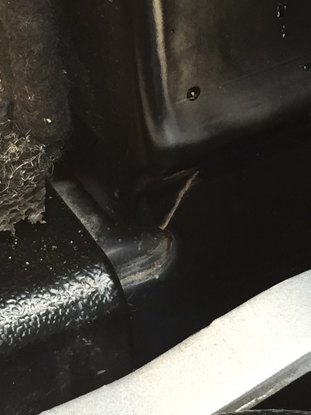

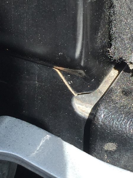

    Here are some pics of the bed structure cracks mentioned earlier today :
    Left corner near tailgate hinge :
    Right corner near tailgate hinge :
    Just so everyone is clear about the corner we are referring too, it is the lower corner of the bed just above the tailgate hinge :

    Thanks. Will keep my eyes peeled. And figure out a way to reinforce it.

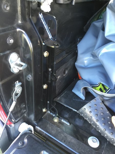

    This is how im going to do it and its functional.
    These are new from TC. Available soon

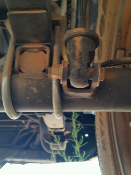

    6 inch Douche Bag lift...what else do I need?
    Went for a drive to see how the new rear set up worked....

    Sweet! Whats the new rear setup?
    14" Kings on hoops and custom leaf pack for my DB lift. but oh, the rubbing now.... Make it stop!

    The rear is rubbing on the fender? Or somewhere up front?
    Tires rubbing the shock body. I'll have to try the Spidertrax spacers I put off installing. FML!

    With my bamf kit and 12" kings I'm running 1" spacers in the rear with no rubbing other than fenders.

    Did you somehow think when I told you that you must use the 1 1/4" spacers to clear the shocks that I was joking ? o_O :evil::facepalm:
    When you use the spacers you will flex even more too...
