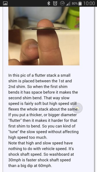

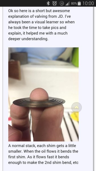

    Some screenshots ive been stealing of good information.
    CMC
    Valving

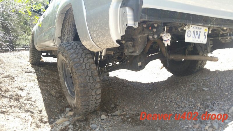

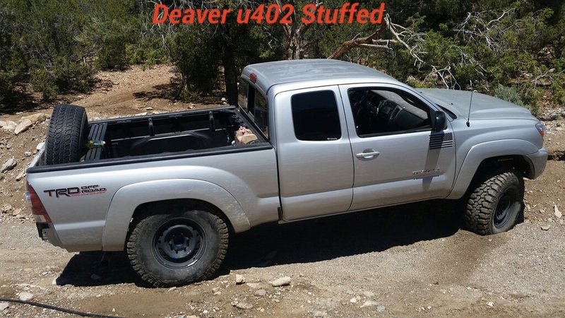

    Deaver u402 leafpack, courtesy of @ryanjboutin

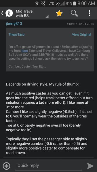

    Alignment recommendations courtesy of @jberry813
