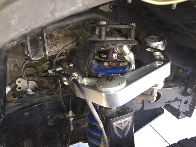

    this is what i had to do to regain SOME travel. I was maxing my shit out for two days and couldnt take it anymore.

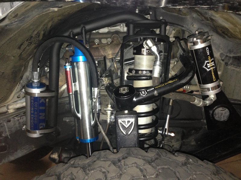

    Ive got ton of weight up front. Steel plate bumper with winch and a 31M battery. I pretty much maintained the same height.
    Here is my preload with stock 13/650 lb Icons springs
    Here it is with 14/700lb King Springs
