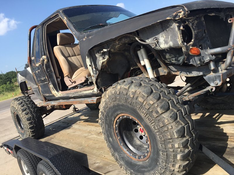

    mark
    TX
    85 extra cab on propane
    1985 ex cab, 92 toyota pickup, 95 4runner
    heres ugly Betty A lil love and shell be great again:thumbsup:o_O

  16. Jul 11, 2016 at 9:47 AM
    #2956
    2ndGenJonny
    2ndGenJonny [OP] Well-Known Member Vendor
    Jan 3, 2013
    #94306
    18,457
    Jon
    Gilbert, AZ
    So much potential... :drool:
  17. Jul 11, 2016 at 9:48 AM
    #2957
    Ugly Betty
    Ugly Betty Well-Known Member
    Dec 11, 2011
    #68587
    1,658
    mark
    TX
    yeah and much easier to work on with all those pieces out of the way:rofl:

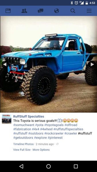

  18. Jul 11, 2016 at 9:57 AM
    #2958
    2ndGenJonny
    Jan 3, 2013
    #94306
    18,457
    Jon
    Gilbert, AZ
    Ill just leave this here for inspiration
    Those fenders....
  19. Jul 11, 2016 at 10:12 AM
    #2959
    RPS1030
    RPS1030 Well-Known Member
    Oct 19, 2013
    #114792
    3,491
    Until it turns into a jungle gym of tubing. :anonymous:
