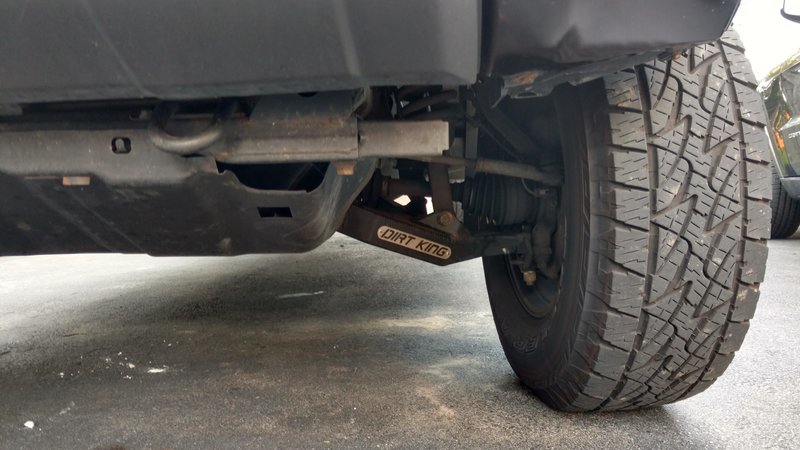

    Preload on the spring sets lift, by trading down travel for up travel. If the coils aren't binding, you should still have the stock travel.
