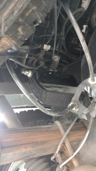

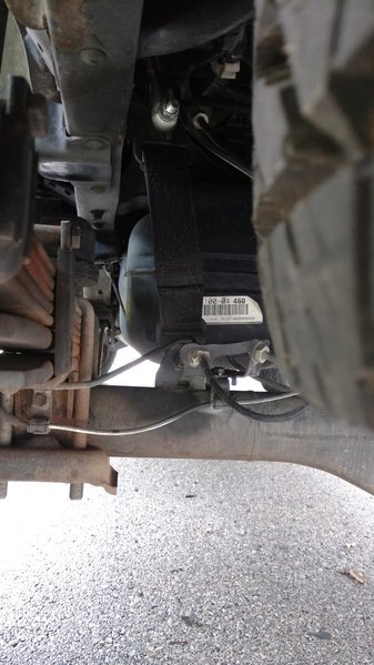

    Straps are cheap, and easy to install, if you can weld. Seems like easy insurance to me, so much so that I have them on my truck.

    You have rear limit straps?

    Yup. Pics in the AM.

    Oh, okay. Is it because your shocks will max out at full droop?

    Yes, I have Dakars and Icon shocks for a lift but they fit the stock mounting location.
    I'm okay at full bump, but I've got about 3" of down travel in the springs beyond the shocks.

    Limit straps, you can see the mount on the axel and the frame plate I added.

    Gotcha. Looks like a 10" travel shock. From your pics it also looks like you might still have the factory inverted shackle? Just curious.
