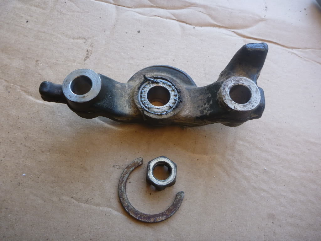

    may i ask why you need a new one? I replaced my driver side LCA and reused that piece. to my knowledge it only makes contact with the steering STOP knuckle to prevent the wheel from turning any more...? Am I wrong?
    EDIT: and of course, attach to the bottom of the spindle haha

    Running LSK lowers and they have a fabricated one, I bought dirt King lowers and the DKs use the OEM steering stop and I don't have them

    for those who have installed the TC LCAs, been seeing some people grind the steering stops and some dont. What did you do?

    Yes
    If you don't they will gouge your lowers, this is true with all lowers except for the Dirt Kings that have a steer stop plate on the LCA. I believe TC also requires some clearance to be ground off of the cup are around where the bolt goes through too for articulation clearance. Don't shy away from tak the time to do all of that now...it will suck to pull it all back apart later to do it when shits not working right.

    Ground them off.

    Grind them to little nubs

    Ok. I'm going to drop the coilover out and cycle the suspension up and down for my bump stop height anyway so I'll check the droop and the cup for contact as well as grind the steering stops to little nubs.
