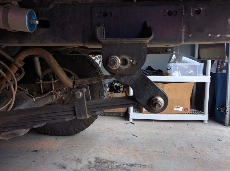

    image.jpg Here's my shackle angle at ride height. Got a BCC shackle flip (canadian company) ATO stock length shackle and wheelers 8 leaf, leaf pack... Should I move the shackle to the middle hole or get a new shackle?

    Its supposed to be 90° at full droop, id say lift it up and move it back one. Also, have you thought about cutting the exhaust where it dumps after the axle?

    Middle hole it is! Will it lower the rear end if I move it? Exhaust is getting done next with the frame plate and custom cross member :)

    Yes, it will squat the rear a bit. Measure it and see how much. Id be curious to find out.

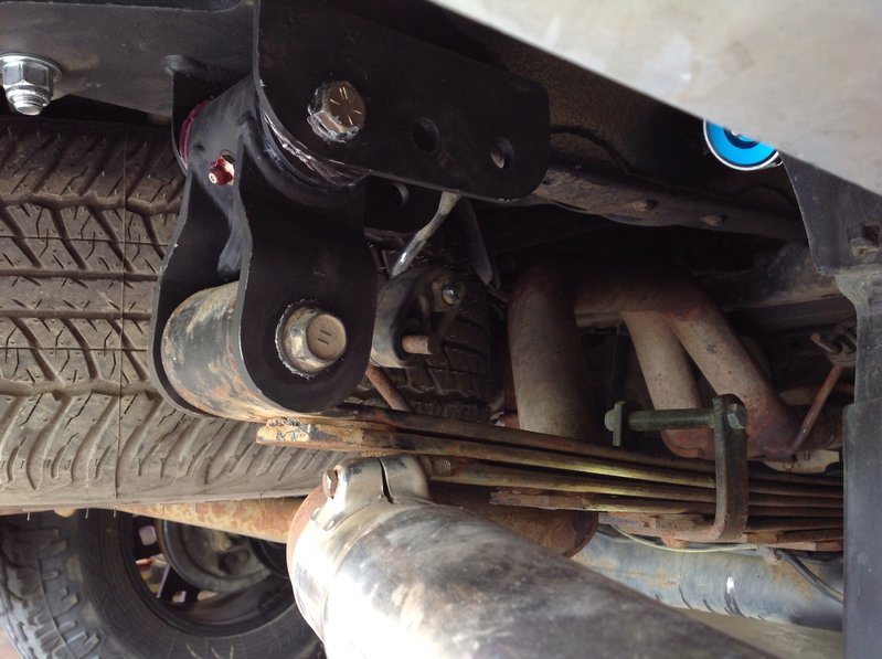

    Here is mine.

    Thanks! That angle looks much better. I'll try the middle hole hopefully this week and post a picture again and go from there! Adobo when will your rear bumper be finished?
