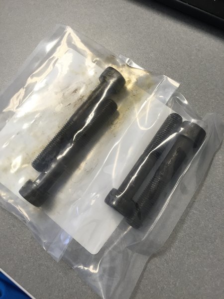

    My bump stop extension bolts came in. This should do the trick so I can add my 1" spacers I made.

    right?! Ill put these in when im checking torque

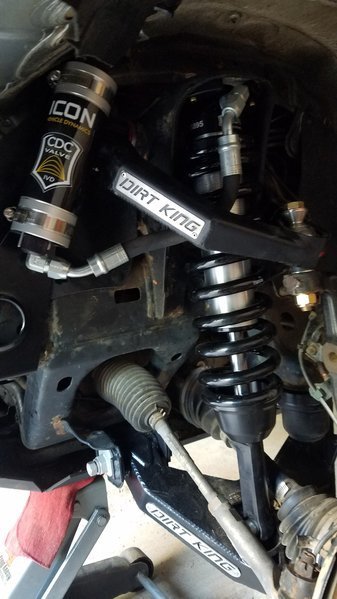

    I'd take a set as well if you have enough material. 1/4" and 3/8" spacers weren't enough now that I have the dirt king uppers and lowers.
    Also, an update on the bouncy issue. It has definitely gotten smoother now that I have passed 500 miles. Still a little bouncy when moving within the truck but that may just be something I have to live with. CDC clickers set to 7 up front and 2 in the rear seem to be working pretty well too.
    Oh, and pretty pictures! (Still need to get some of the rear)

    13,385
    Sam
    NorCal
    bump spacers, for super bumps. I bought a sheet of UMHW and a 3" hole saw bit. Gonna make my own spacers because eff Wheelers.

    #101544
    13,385
    Sam
    NorCal
    with superbumps and the superbump wheelers supplied bolt, it would thread the bolt inside the TC spacer out when installed. Thats why i bought the new bolts with the proper length.

    Sam
    NorCal
    its close to the right height, i have two 1/2" spacers cut currently. going to stack them and use the longer bolts for the install. It will be just above what the TC supplied ones are. Im guessing because 35s.
    Also, without the threaded bolt from TC, the superbump bolt wont go through the spacer and the bump with enough threads to grab. Barely threads.

    NorCal
    yeah, not something i want to find out first hand on lol.
    but an inch overall spacer for the superbumps should do the trick.
    Im hoping i can get it going without lowering the LCA to get the allen head in. Also need to try to get a 12 point on the bolt to torque, that might be a bitch.
