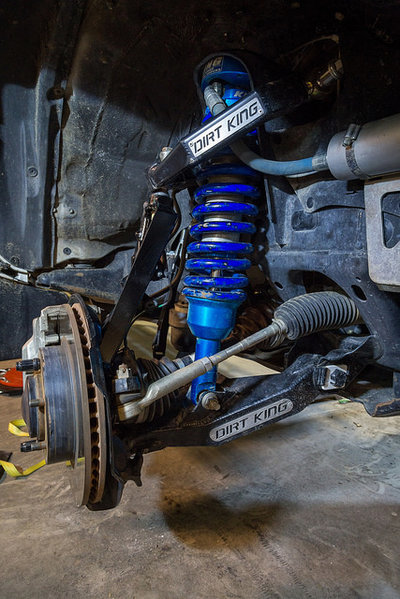

    Does anyone know whose front setup this is?

    @SconnieHailer it looks like

    That's me.

    Badass setup if I may say :thumbsup::)
    Was wondering if those bump stops you have in the rear make a big difference? And how do you like the front?

    All around its been a great setup. The air bumps in the rear are my favorite part about the rear. The front needed a stiffer comp valve and limit straps before it was perfect for me. It handles everything in moderation, it's not a hucker or anything but it soaks up a nasty two track way faster than your average mid travel can.

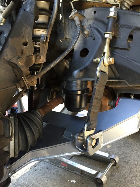

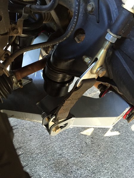

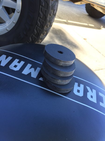

    Got home and installed these and checked the torque on everything. The lower uniball wasn't loose at all after 400 miles so that's good to see.
    Bump extension is 1" it looks like a ton but @Wishbone Runner understands why lol

    I wanna see how this works tomorrow :). Bring your GoPro.

    :cheers: Nice work on the home fab spacers.
