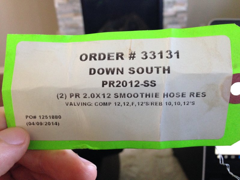

    This the sticker they sent me with the shock, excuse my ignorance to the terminology. I am no shock valving engineer I just told them the angle I need to mount them and the weight of my truck and this is what they sent. Seems to ride pretty good.

    So compression side is all 12s with a flutter and rebound is 10 & 12. Assuming that F is for flutter.
    @jberry813
    What do you think?

    (2) 12's, flutter, rest of the stack 12's on compression.
    (2) 10's and the rest 12's on rebound.

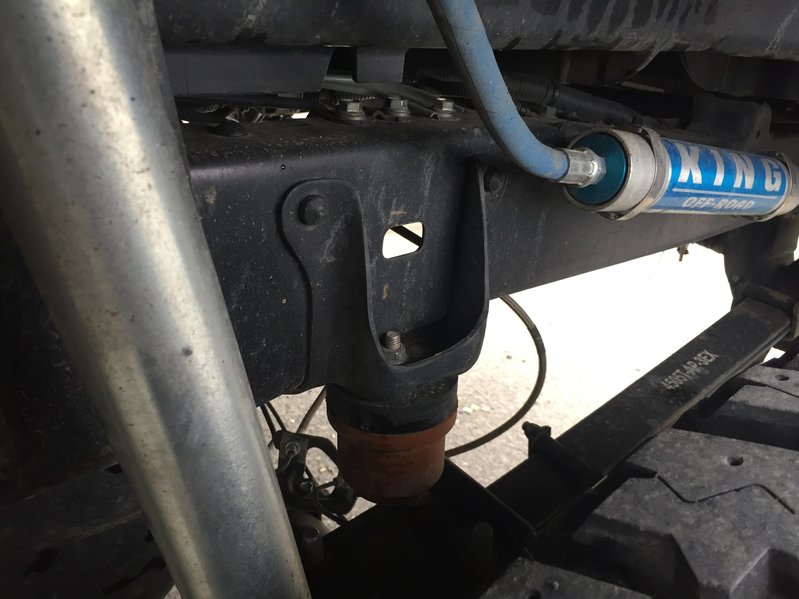

    I have no rub using the BAMF setup. Its all about the proper backspacing and bump setup. Im running SCS SR8s with no rubbing issues.

    Do you have a pic of how you set up your bumps?

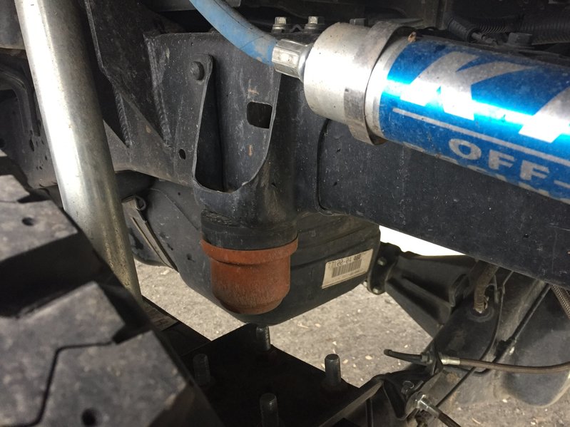

    Why do the bumps look rusted? Aren't they a rubber/poly material?

    Nice! What leaf pack and I assume 3.5BS?

    Just the color of wheelers superbumps
