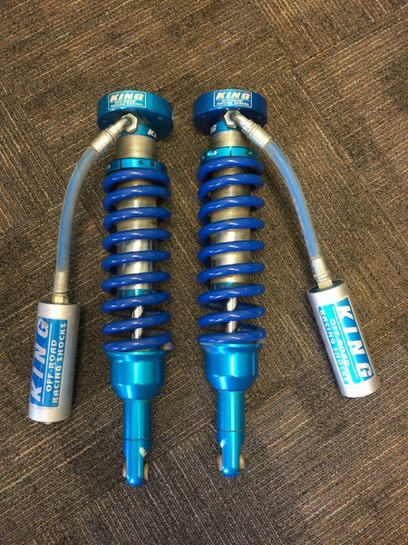

    Wonder what these could be
  4. Aug 3, 2016 at 12:29 PM
    #3424
    2ndGenJonny
    2ndGenJonny [OP] Well-Known Member Vendor
    Jan 3, 2013
    #94306
    18,457
    Jon
    Gilbert, AZ
    Nice! Are they new or did you buy Brians?
  5. Aug 3, 2016 at 12:30 PM
    #3425
    LTDSC
    LTDSC 32oz of fun
    Apr 7, 2013
    #101544
    13,385
    Sam
    NorCal
    i bought Brians Kings.
