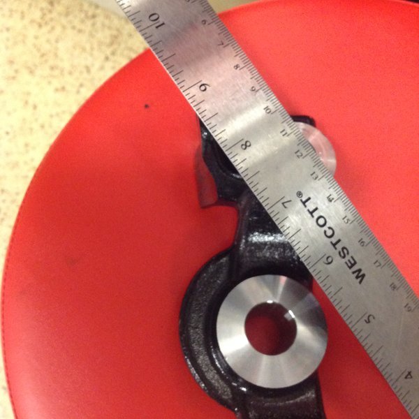

    On the DK lowers with the steer stop part on the lower you can absolutely grind your OE steer stops and you will regain a ton of turning radius. Grind the back edge of the steering stop at a 45 degree angle like this and it will clear enough material and hit the LCA at a perfect angle :
    LTDSC and Large[QUOTED] like this.

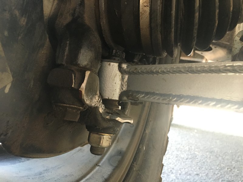

    Here is mine. No steering stop

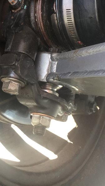

    Here is relentless.

    #3715
    LTDSC
    LTDSC 32oz of fun
    Apr 7, 2013
    #101544
    13,385
    Sam
    NorCal
    thats how mine looks as well ^^^ I didnt have to cut the uniball surround, just the steering stops.

    I grinded a bunch off the top part of the adapter so it would clear the arm for up travel. My steering still hits

    Wow, so the LBJ adapt still hits the lower just a little bit even with the stop chopped off ? Looks like both of you have the same small marks next to the uni cup.
  19. Aug 12, 2016 at 8:01 AM
    #3719
    Mademan925
    Mademan925 Senor Taco
    Nov 7, 2012
    #90668
    7,640
    Nick
    Discovery Bay, CA
    2014 4x4 TRD OFFROAD DCSB
    enough to go over stuff
    Yep.
