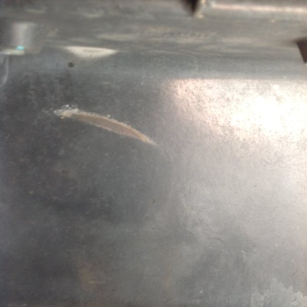

    Exhibit A - this is tire rub mark on my bed / inner wheel well that happened when I still had leafs and OE shock locations. I can't remember if it happened when I had 285's w/ a 3" Denver pack or if it was when 8 had 35's ? I then later installed hoops that were tucked right up against the wheel well and the shock sat as close to the frame as it possibly could and my tires then made rough sex with the shock bodies. This is why I keep saying that tires will hit an outboard mounted shock...it happened to me. I'm not saying don't do it, just be aware and mock it up first because again spending all that cashola and then realizing you lost travel is a bummer.
