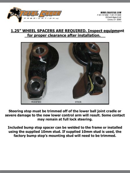

    Did anyone post these up yet? If not, was this what you were looking for?

    PS, those were it! Thanks

    That is one of the diagrams we are looking for, it shows how to chop the steer stop but it does not show the clearancing needs to be done on the LBJ " cup " area. Maybe when we find both Jon can add a link to the OP.

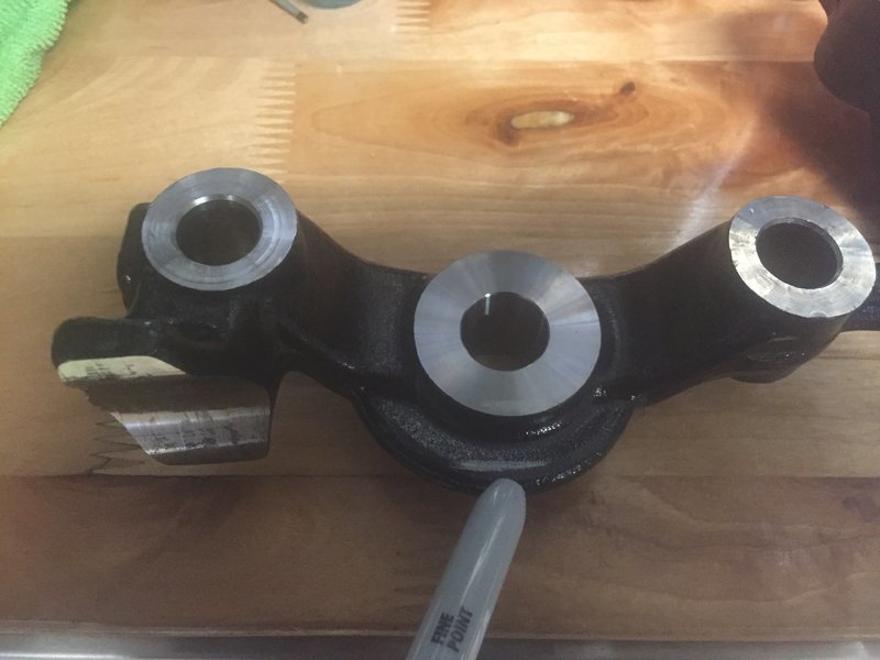

    Jon, I am talking about a different spot not the same clearance issue you had with your old DB spindles. The older TC instructions showed an area of the LBJ adapter near the misslignment spacer that need to be beveled so it would clear the LCA at bump. I happen to have an extra for mock up ( top secret project ). This silver paint pen mark represents the area i think had to be clearanced :
    edit - also remember a couple of years ago we were having the convo about folks with TC race lowers getting that half moon scar on the bottom of the lower near the uniball cup ? it was from the LBJ adapt hitting the bottom of the LCA

    I looked while under mine this weekend and I didn't have marks just the marks from the cut steering stops impacting the edges. I'm not sure if mine doesn't compress fully to impact because of my bump stops or what.

    Same here. My steering stops are really making a good dent in my lowers. Wish there was a flatter spot for the stop to make contact with the LCA.
