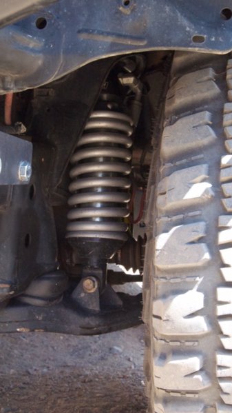

    Alright I've got a quick question about bumpstops on a first gen with mt.
    First, many people use wheelers bumps up front in the stock location but since the bumpstop itself is too "long" you get virtually no uptravel before you are bumped. The wheelers also bump all weird an off camburg an buldge out the side etc.
    To throw a hydro in is still a thought but would require new bump plate and some fab, which I'm fine with.
    So the question is.. is there any good solution for bumps on a first gen with mt?
    Haven't found much when searching the search up top or google... thanks:cheers:

    Yea I understand, this is how the wheelers sit in the front bumped an the shock is stopping before the bump really making the bump worthless almost?
    Adding spacers to it would make the truck just sitting on bumpIMG_4086.jpgalso have heard that on hard hits the bump completely deflects off to the side virtually allowing there to be no bump
