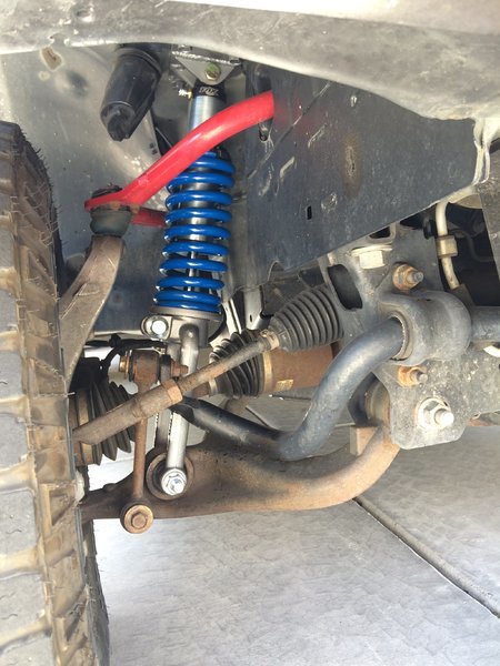

    It's only bad to preload your springs to the point that you run into coil bind.

    I would say make sure that is the correct length spring for that shock. The fox is set up quite different than the bilsteins. Other than that seems like a pretty light spring rate to me. What vehicle is it on?

    Measure the amount of space in between each rung of the coils and then measure shock shaft length.. If the shock shaft length is smaller than the coil gap total length then your running into coil “binding”... aka: not good

    I was pretty sure the coil wasn't going to block before full bump when I measured everything out but it wouldn't hurt to double check. I see exactly what you mean if you preload too much then coil can bind when the shock compresses. They are 12" springs which is the longest I could get with the original Fox 2.0 X 5" rod ends/spring perches. My clevis adapters and spring perches didn't take away any shaft stroke.
    This is on a Jeep Liberty :crapstorm:
    I didn't have a way to weigh the front end for the calculations, I just used OME's HD springs as a reference (400 lb) stock is 310 lbs.

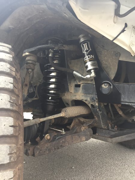

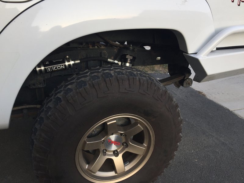

    Rears done. Fronts soon

    Fronts done. And some flex

    Did you get the adjusters?

    No CDC. These are Icon 2.5 with resi, 700lb spring, and standard travel
