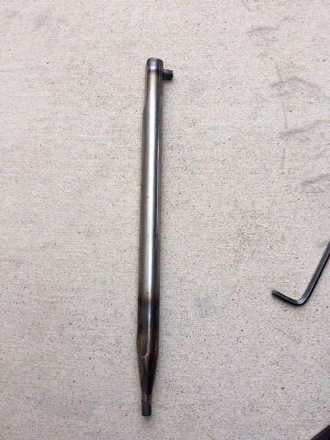

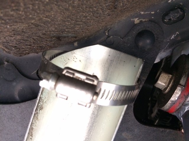

    Thanks for the replies about my adjuster tool question. I actually compressed the springs on the bench prior to install and got them almost spot on for my desired ride height. I just made my own tool with a 5/16" punch and some DOM. The right angle end can sneak in between the adjuster ring and the coil bucket for that last few degrees you need to get around the resi fittings.

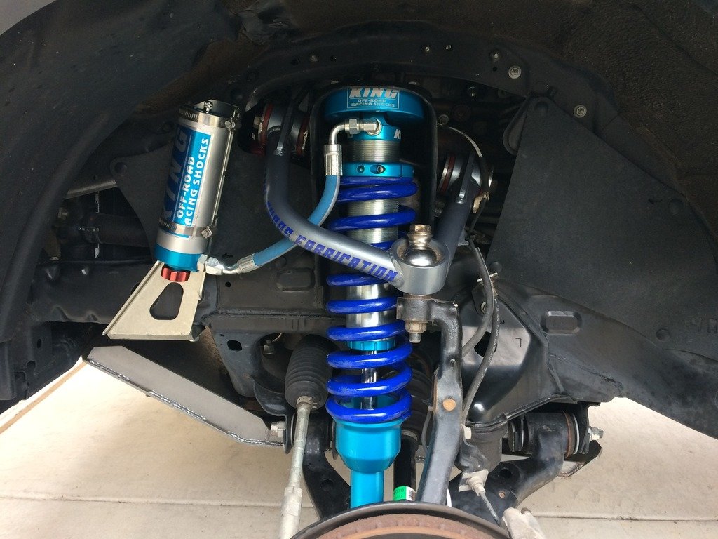

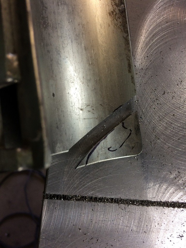

    Also, for those who have the newer style resi brackets, any issues with the wheel well hitting the brackets or reservoir? Mine was just about touching the inner fender so I cut the bracket and mounted the reservoir as low as possible but it's still close.
